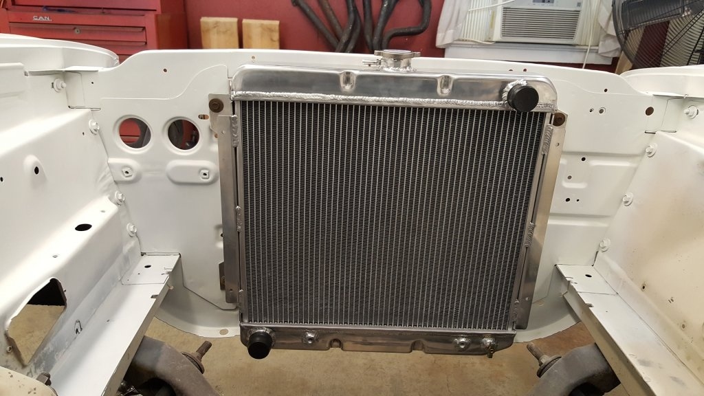

I bought one from them for my '62. Seems like a good piece, I haven't ran it yet but did a test fit. When I received it, the fins were a little bent over from the styrofoam that they had up against them for shipping. Spent a little time straightening out but no biggy. I like the fan shroud piece on each side. No chance of screws through the core.

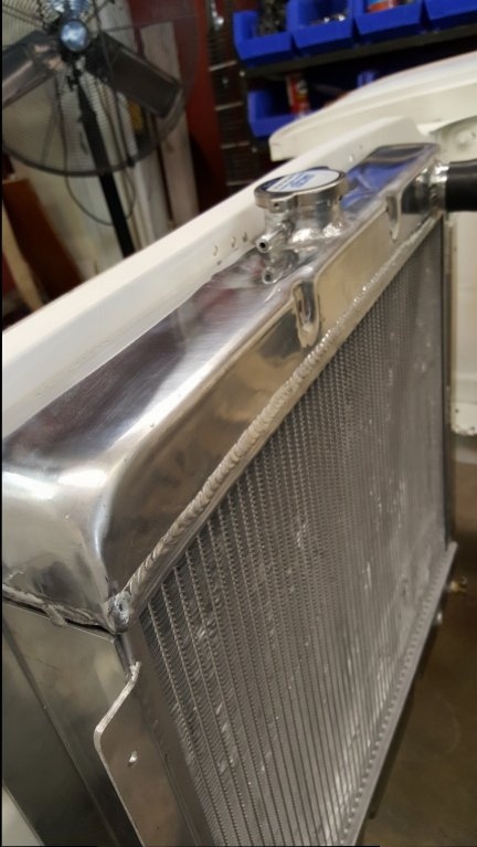

View attachment 390790 View attachment 390791
Thanks for posting the pictures, radiator looks really nice. The angle of the second picture makes it look like the filler neck sticks up a little high. Have you checked for hood clearance? The reason I'm asking is that the aluminum radiator I bought from Mancini a few years back for my 65, the cap hit the hood when closed. Although I hated to do it, I ended up smacking the filler neck with a dead blow hammer to gain clearance, about an 1/8 inch. The way it's made I couldn't slot the holes to move it down. Again, thanks.
Actually the radiator sits a little lower than the factory one. I'll probably have to hold it up a tad.
This one is almost an inch shorter than the factory so hood clearance should be ok. (My hood is removed at the moment)
These are for the newer "B" bodies, probably why they are shorter and the lower passenger bolt hole is higher than an early model. (See the drawing with measurements in the link posted)
It's close enough to work in my '62 and I liked the rounded look.
Actually I think they are designed to accommodate the earlier models and later without a lot of modification. More so on the later models.
