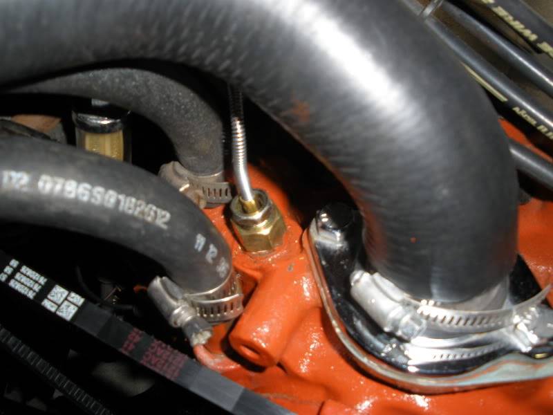

My Satellite wagon with a 440 seems to run at 210 even with the 160 thermostat in it.
Could this reading be because I have the gauge sensor in drivers side of the block in the drain hole instead of in the water pump housing?
I have my dash gauge in the WP housing and it seems ride at a reasonable needle position but the 210 on my autometer gauge still has me concerned.

update: I moved the sensor; still running hot
