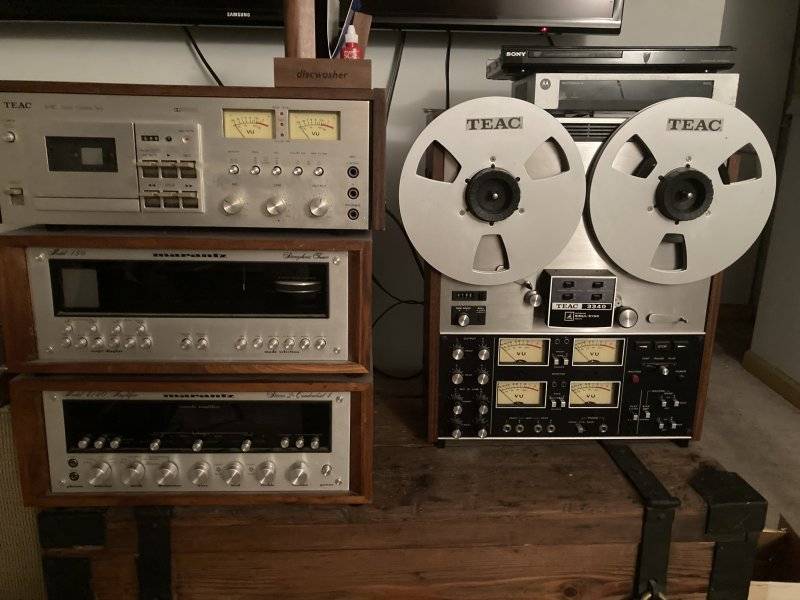

Oooooh! Dems fightin’ words! As a man who’s daily driver home system is a Marantz quad, I take exception!
