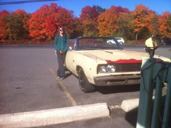

I didn`t read all these posts, but in 1969 I bought a new coronet RT,440 4 speed, w/ power steering only. Car fast as hell on the hi way , not so much in a dragrace. It had a slight knock at idle, turned out to be the heat riser fluttering, I wired it open .
