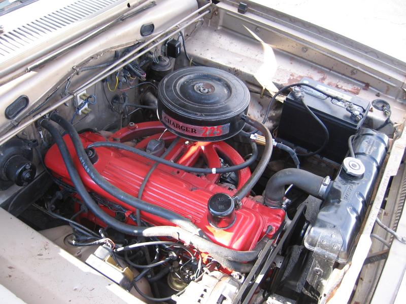

Find yourself a Slant 6 lid like the one in the photo with a breather tube 64-69. Buy a cheap auto parts store 9'' chrome air cleaner,ditch the chrome top and use the filter and base. I did this to several cars and on my 79 300.Don't have a photo of the 300 engine but you'll get the idea.

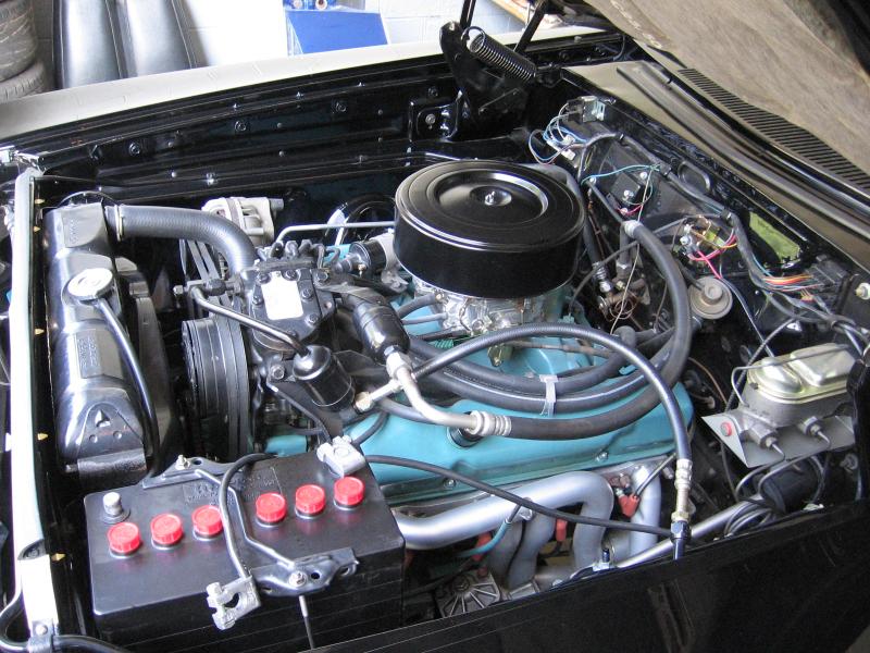

Another photo on a 383. This is for UN-silenced early look.

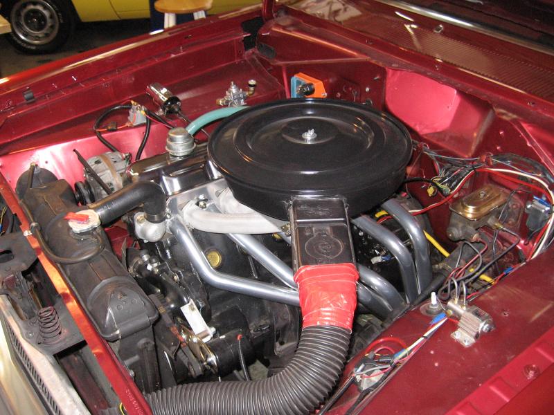

OR ,, This is a mid 70's 360(Cordoba,non leanburn 4 barrel) with a cold air tube routed to fresh air on a race Dart.If you can find one that has the round snorkel tube atachment point it would look better.But was a easy way to pick up 4 tenths for about $10 bucks.Flex tube was from a K-car.
Just another Idea to look at.
Also clears fuel inlet and choke.
