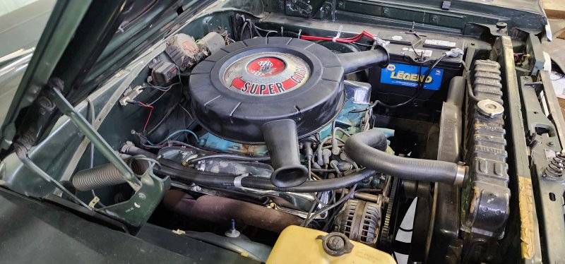

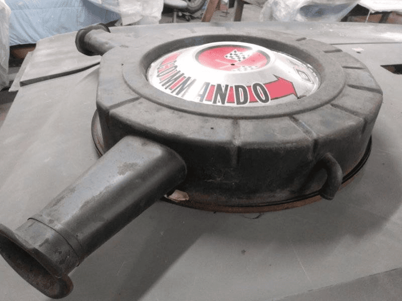

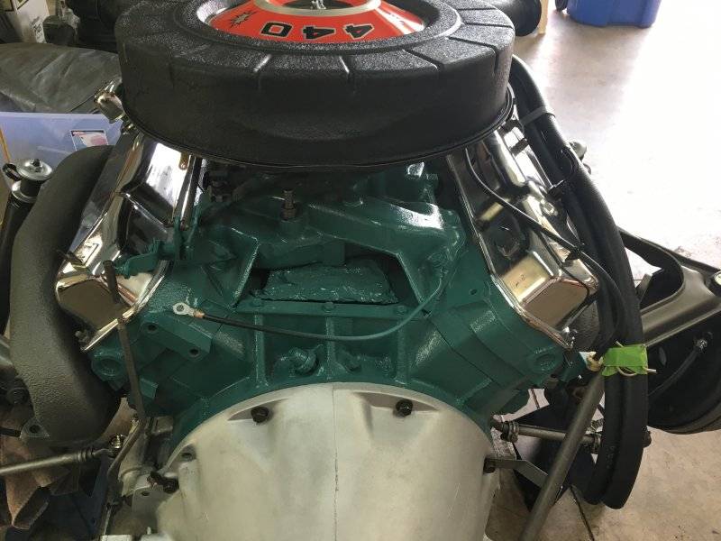

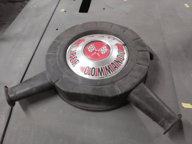

13 notches and no nipple.
Wow you're fast. Nice R/T, too.
OK, no nipple whatsoever. Anything about the back of the air cleaner or the base that I should watch for??
Thank you, Kevin

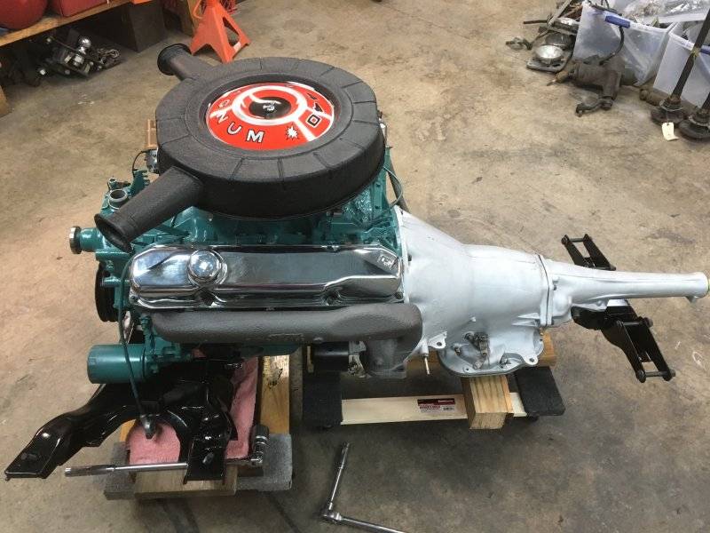

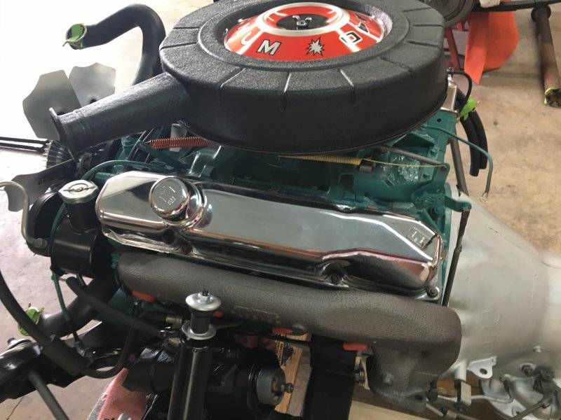

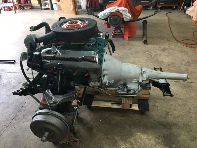

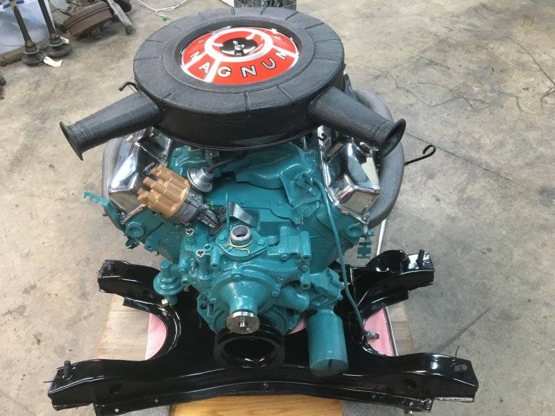

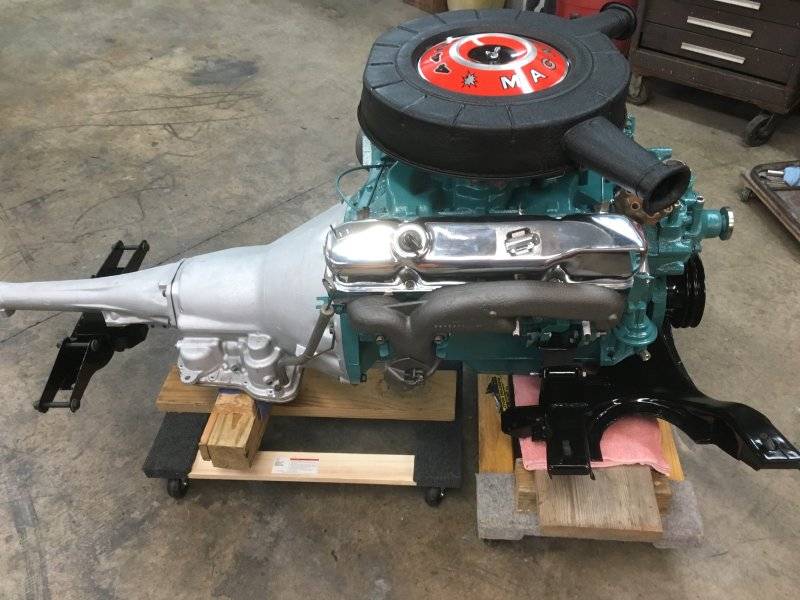

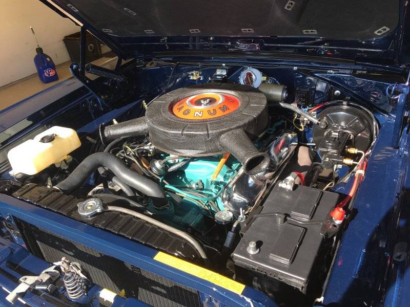

There’s only one air cleaner that’s ‘right’. Small flat in the back. I haven’t run across one with 13 indents that has a different shape yet. The breather nipple is the only difference.
Amazing! I just looked at a few pages of your post showing the restoration of your car and I'm blown away. Thank you for sharing all the information. Beautiful work on a gorgeous car.
Thank you for all the pics you attached to this thread. With your sharing, now I can confidently find the correct air cleaner for my car.

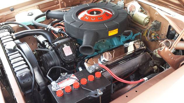

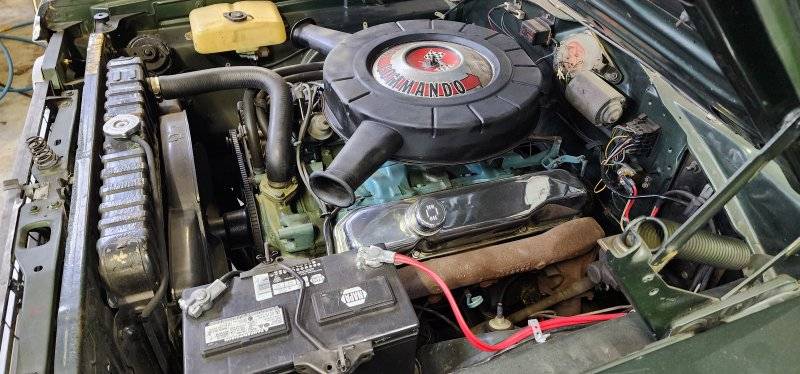

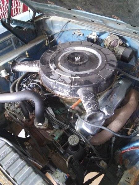

The air cleaner on my original R/T, well weathered, does not have wrinkle finish paint. It's just a non-glare, but not flat, black paint. Very similar to the black on the radiator tank.

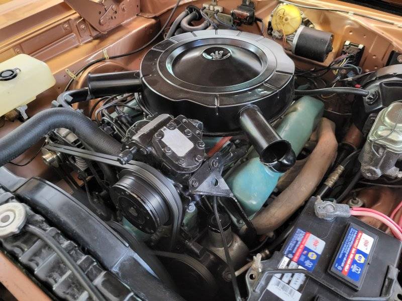

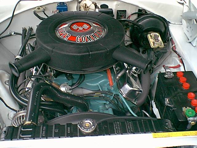

67 GTX, same Air Cleaner. Automatic or 4-speed. 4326S & 4327S
and it's a crinkle finish correct Jerrry?
Yes, both Dodge & Plymouth. The Satellites with a 383 had a dual snorkel but the snorkels were different and they were semi-gloss with no pie tin.
AWESOME! Thanks to all who are chiming in. Appreciate all the knowledge. I'm getting excited seeing all these big blocks with that bad-*** air cleaner, wrinkle or bare, tin or no tin!! The non-CAP simplicity makes it even better.
