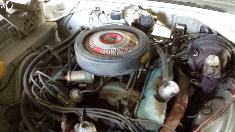

Looking for a dual snorkel for my 68' 440 GTX- I believe the original part # is 2899-133-Thanks
68 gtx should have a unsilenced air cleaner no snorkels

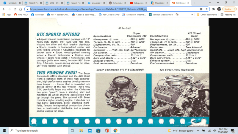

From what I understand, it could of been an option- I would like to know for sure if this was ever the case.
https://www.hamtramck-historical.com/images/dealerships/DealershipDataBook/1968/68_Belvedere0004.jpg
not an option per se. It would have been dictated by: Motor size, Trans type, air conditioning, and whether sold new in California or not.
