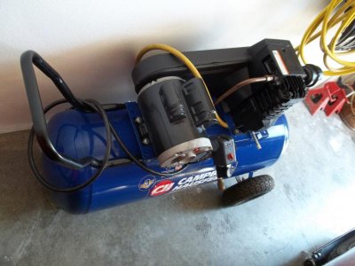

New to me Air Compressor .. suggestions on what to do before use / best experience :)

Painting with that size comp shouldn't be a problem.
I've painted things larger than a car with a smaller comp.
Ratchet and impact gun probably OK. My cheap HF ratchet actually uses more CFM than my IR impact (and it's the older version of the Thunder Gun).
I don't know if I'd spend the money on a blast cabinet, though. Like I said my 8.4 CFM DeWalt/Emglo will barely do something the size of an oil filter, and that's with borderline excruciating wait time. Blast cabinets are kinda pricey, and it'd suck to be out that cash and have to look at it sitting there. You could try one of the cheaper "spot blasters" if you wanted to find out for sure. Honestly, I don't think I'd even reccomend that.

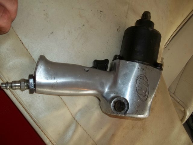

Thanks for sharing YY1. He had the IR 231C and I'm pretty sure it works. I haven't tried anything yet, cause I didn't want to jump in and haven't torn into anything needing it yet. I have some air tool oil and I guess i should go ahead and oil them. I'm assuming a few drops and keep them leaning upside down so it can work it's magic. I know he did regularly.
Here's the tools and stuff I have. From memory not all work but he said some were rebuildable.

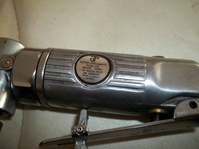

This one was used a bit to clean off surfaces for new gaskets. I don't know if he was able to use it for anything else but I'll experiment as the need arises.

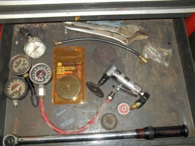

Here is the rest of the tools
This one works I think
This works too from memory again but doesn't have any labels
This is a Snap-On that he said was rebuildable but I don't think it's working now

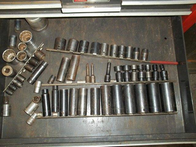

Sockets etc

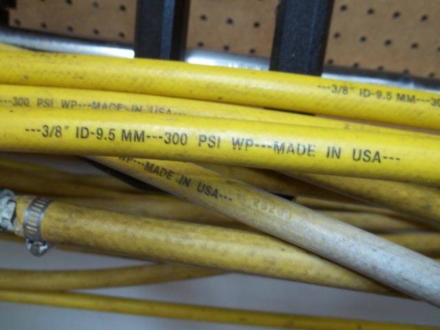

Hoses

The benefit of re-wiring that for 240, at that age, and its limited output is pointless. Donny is right. I have Craftsman 33 gal that is wired for 240, puts out 6.4cfm, and THAT nearly runs constantly for even a die grinder. So relegate it to tire inflation and other small tasks. Electrician with 25 years experience.
Looks like you're pretty much set.
I'd go ahead and get a cheap paint gun. You might be surprised how good you do.
Scott's right- waste of money. I can do it my self for my Dewalt, and haven't done it yet because it just aint worth it.
(even with $0 labor, and "at cost" parts)
If it was twice the size, it might be a different story.
He's also right that the cut-off might drain your tank. Just gotta try it.

Spend the extra money and get rubber hose.
Not PVC. It doesn't flex and you will curse it when it's cold.
My Harbor Freight store has Goodyear rubber hose.
I think it's the only thing they carry that is made in the USA.
Other then the country music they play.
I'm getting tired of fighting that damn hose in the few times I've used it so another air hose solution will be in my future before long. I may get the one Gpuller posted but will probably shop around because I over think everything LOL
On the hoses...I have the Flexzilla hoses from Legacy. They are supper flexible and dont have a memory so they coil up easy.
http://www.amazon.com/Legacy-HFZ3850YW2-Flexzilla-Zilla-Green/dp/B001C6NC7O
I'm thinking I'm gonna be wanting some like this soon. Thanks Gpuller

Thanks Matt and I appreciate the condolences. Compressor looks great, drain valve is solid. When I opened it 2 weeks ago no water came out. It was used for less than a year by my bro who bought it brand new and he drained it every time he used it. Still looks brand new. I only mentioned changing the drain cock because it's a pain in the *** to reach it (I have a big belly) and it sits so low to the floor I have to lift the compressor to get my fat hand down there to drain it LOL.

Well i got Ol' Blue cleaned up and used it to finish putting the skates on. It kicked on a few times but the 3/8" ratchet works and it saved a lot of stress on my old elbow.
Was a welcome friend in that project.
Want to come clean up mine? Haha mine is about 8 years newer and looks a whole lot dirtier then that !
