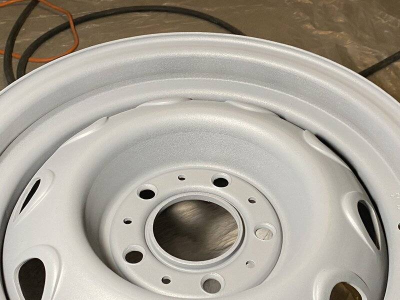

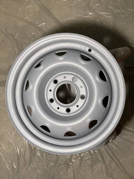

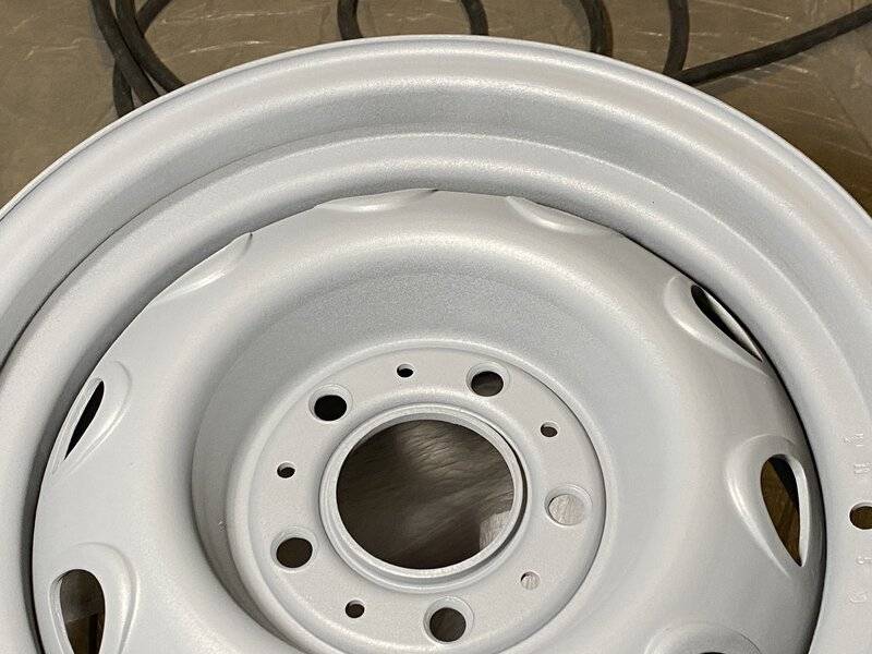

I’m in a difficult situation, poised for failure and I need some advice on how to salvage my Rallye wheel refinishing that has already been set in motion.

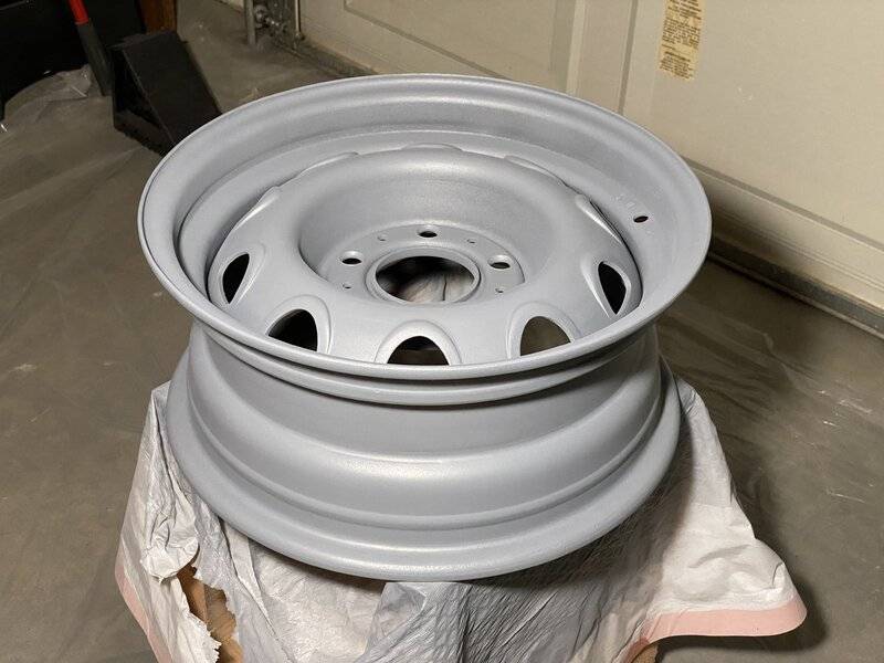

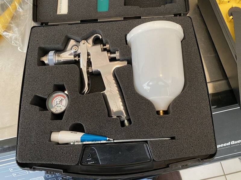

This is the situation. Thus far I have primed the wheels with Omni MP17X Epoxy Primer. I did this using and Iwata HVLP gravity spray gun #9276. The gun requires 12 CFM, which I didn’t realize when it was sold to me by the shop that supplied the paint.
The compressor is a RIGID pancake 2.6 SCFM, 6 Gallon tank, 1.5 HP. After doing this I have now painfully learned that this Pancake compressor is woefully inadequate for feeding air to my spray gun.. It runs continuously and can’t maintain a constant 20 psi at the gun, even for 2 or 3 spray passes with the gun.
My primer was applied two days ago, and I must get paint on it by end of day tomorrow. It only has a three day sit period. I used a 1.5 needle for the primer. I got some spattering of the primer during the spraying.

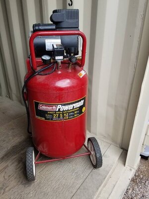

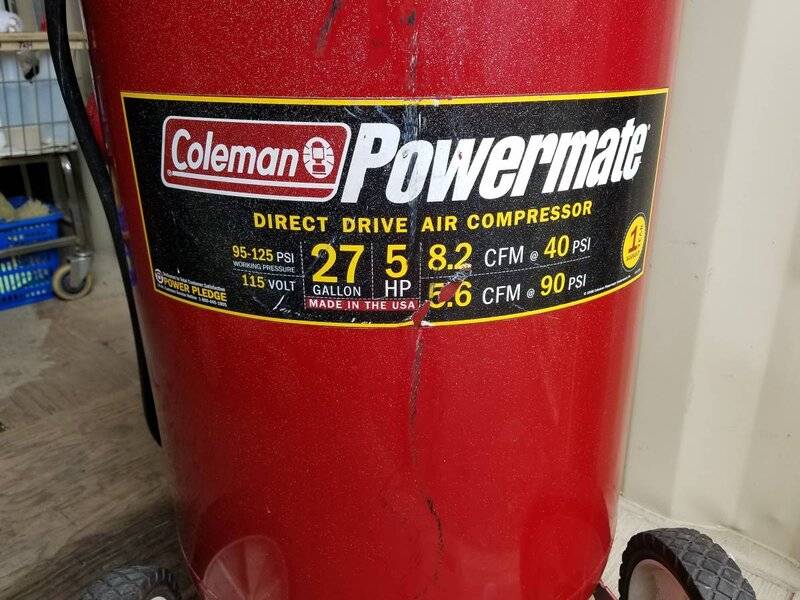

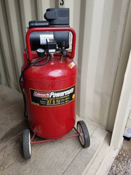

There is a used Coleman Powermate compressor for sale in my area. 27 gallon tank, 5 HP, 5.6 CFM (not SCFM) at 90 psi, 8.2 CFM at 40 psi. I noticed the label on this compressor says CFM instead of SCFM, like most consumer compressors have. Maybe this compressor might do 10 CFM at 20 psi?
Do you guys think this compressor will allow me to get decent paint coverage on the 4 primed wheels with Omni MTK Acrylic Urethane with a 1.3 needle?
I need to make a decision to buy the compressor tonight.. anything at Harbor freight, Home Depot or Lowe’s looks like it would be less CFM than this Coleman unless I get the most expensive, and largest compressor they have available.
I feel I need some other compressor for spraying the Argent Silver for it to look decent. The primer came out OK, considering the pancake compressor that was used.. now that I know the gun is supposed to require 12 CFM, I am shocked that the primer came out as good as it looks.

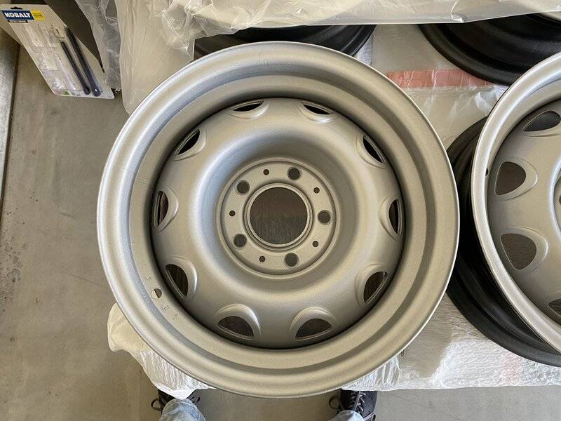

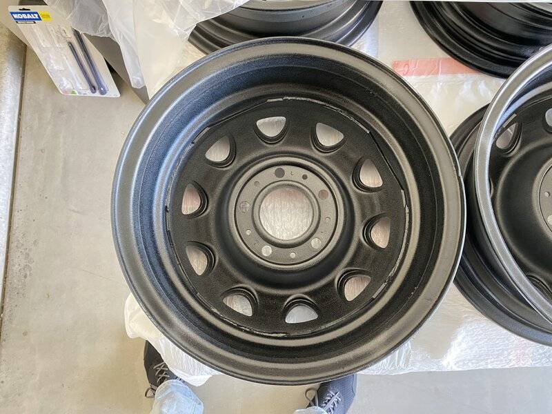

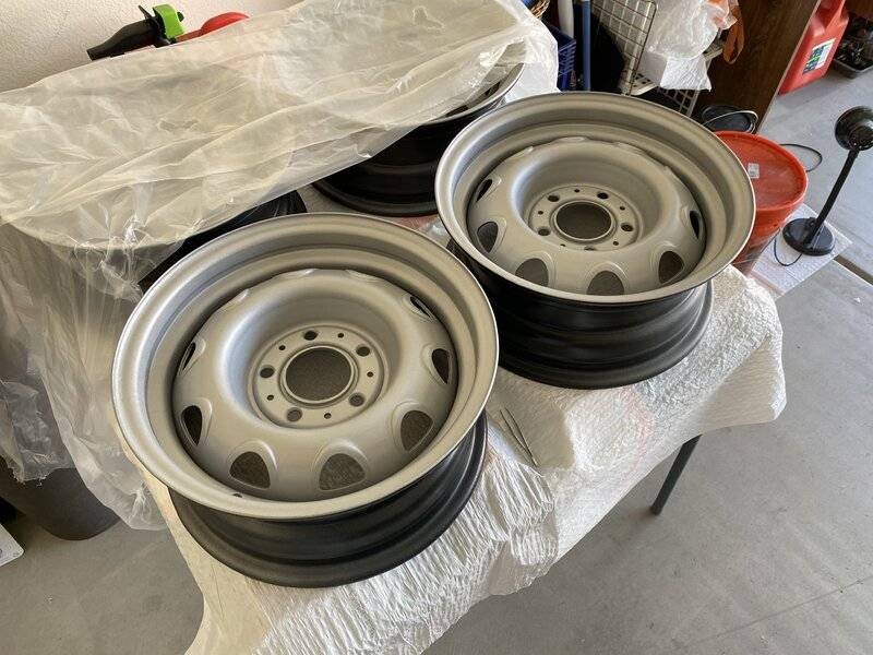

I was able to paint the wheels this past Saturday. It was NOT pleasant trying to use a compressor with a 15 Amp motor plugged into an outlet that is on a 15 Amp circuit breaker.. This was a big surprise after he had already dropped the compressor off and I paid him $100..
I lost count of how many times that compressor tripped my circuit breaker when it tried to auto cycle. Each time I had to switch off the compressor, set the gun down, walk around to the side of the garage, raise the breaker panel door, reset the breaker, then turn the compressor back on. I got lucky and it would actually run until it reached max pressure when following that routine. First time it tripped the breaker I thought I wasn’t gonna be able to use the compressor at all.
You can’t get much more of an adverse condition and environment than I had for painting a set of wheels.. I never imagined the monsterous amount of overspray that would fumigate the garage. If I had not had my car covered with an old car cover and completely covered with two layers of plastic on top of that, I would’ve ruined the car.. I don’t remember the overspray being so bad back in 1992, but back then I was painting out in the open and not inside garage. I’ll never spray automotive paint through a spray gun inside my garage ever again..
I wore a respirator mask, goggles, earplugs, old hat, old pants, old long sleeve shirt and shoes. After completing the painting the bottom of the shoes were so badly covered with paint residue I had to throw them in the trash. In contrast the same shoes didn’t look too bad after shooting the primer. The paint on the other hand destroyed them.
It was suggested above that I use a cheap Chinese $19 spray gun from Harbor Freight... Really??
I used a $200 Iwata gun. And the outcome of all this was OK, but nothing to rave about. Was not happy with how the black paint went down. The black primer sprayed better than the black paint.. The argent silver looks decent.
The red compressor is what allowed me to complete the job, though with difficulty.

Sadly the original poster could have used a $1500 dollar gun made by any manufacturer on the planet, and if the tool's air consumption was greater than the compressor, the same headache would have resulted.
#1 If you're going to do this stuff, you have to 1. know your compressor specs, and then 2. purchase a spray gun that operates well below that.
If a person loves the Iwata brand, Iwata makes awesome spray guns that can operate within the air volume limitations of a 2.4cfm pancake compressor. Like this one, for example, the LPH80.
