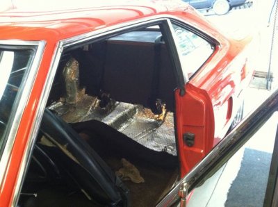

I didn't want to pay for the Dynamat either. I used a foil type wrap for a hot water heater tank from the big box store with some good foil type hvac tape. Pretty happy with the results. I only did under and around the back seat.

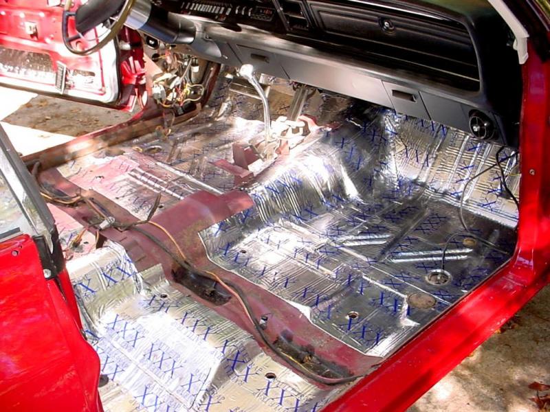

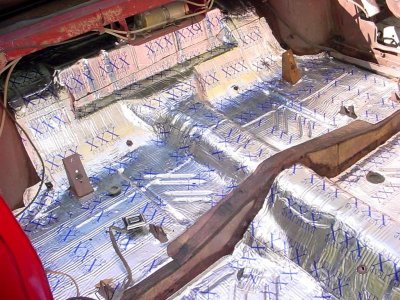

I used a product called StP on the floor of the car - similar to what Prop did (It's only halfway done in the photo, eventually went all the way up under the dash). I DID use Dynamat on the doors because I found that it was a little easier than the StP to get into the nooks and crannies, and because they have a ready-to-go door kit. Very pleased with both...

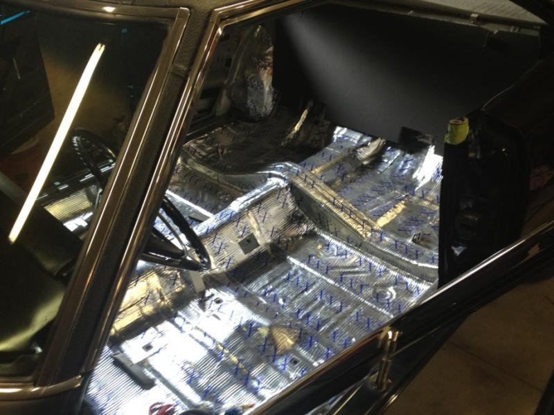

I bought a 50 sq ft roll and used almost all of it to cover the entire floor, (69 300 conv). Got it off ebay with free shipping, and they even included a application roller and box knife. All you need is a good heat gun to install.
I'd recommend it to anyone

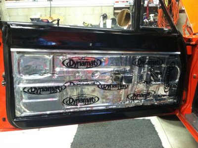

I put it on the inside of the door skins on mine. Limited as far as the size of pieces that can fit through the openings, but just had to take a little extra time and puzzle together several pieces instead of one or two big ones. Somehow or another I could see having to have access to inside the doors, so didn't want to dabble with removing or cut and repairing to do it. To each their own I guess.
