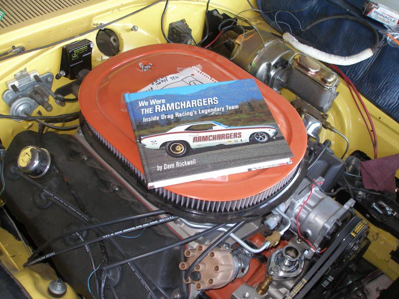

BPE AC Kit on a 1970 Superbee with Hemi
Hi snakeoil24
I put the BPE (bouchillion) on my 1970 Hemi.
No issues what so ever.
Plus, I mounted My Sanden compressor (supplied w/ kit) on the top, in front of the drivers side head BUT there is a hidden compressor MOD that places it below the Passengers head near fuel pump.
PIC of mine:
