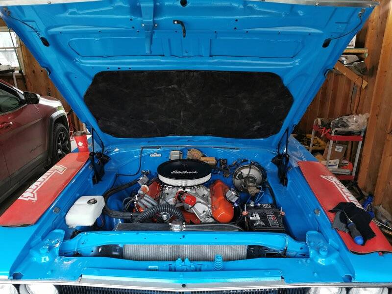

In my 1970 Plymouth Satellite, I've got the 440 with the Performer RPM intake and an AVS2 800. With the stock Satellite hood, I could never have fit a full size 14"X3" air filter. I have to run a 14"X2", which just fits with the air cleaner stud poking slightly in to the hood insulation. The question is, am I starving my engine of air, and therefore power by running this 14"X2"? Aside from a chassis dyno with both sizes of filter, how would you determine this? If it is too restrictive, my assumption is the only answer would be a new hood with a scoop on it. Am I worrying about nothing or should I be digging further in to this to get the answer?

The Edelbrock air filter in this photo is the drop base unit, about 1" or 1.25", something like that.

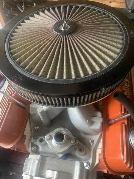

K&N has a filter top. One for there filters, one for everyone else’s filter. The size of the filter top gets smaller with the one size fits all while the K&N filter is thinner allowing more filter area on the filter top.
This allows the air to come in straight downwards which is a big help.

I used that same intake on a 69 Charger a few years ago. Ended up with a 1.25" drop base, I believe a 2 5/16" filter, and the open K&N top as shown in a previous post. Also removed the hood insulation. Look close at how much restriction there is with a 2 inch filter and a drop base. That is why I went with the open top.

On that test, the top filter made more power, than a top filter/2"standard filter combo. They taped off the standard filter and it made more power.
HOWEVER, I think that was with a carb with no choke tower. Results with a choke might be different. Bottom line of that test: airflow Direction is important..
The filter top would probably help the OP..... but I wouldn't run it with the hood pad.

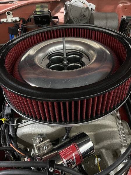

Recently I was running a "flat" base on my air cleaner and the 3" is too tall, had to drop down to a 2". Reasoning was to clear the AN fittings for my FP gauge.
Decided to ditch the underhood gauge, so have put the drop base and my 3" back on.

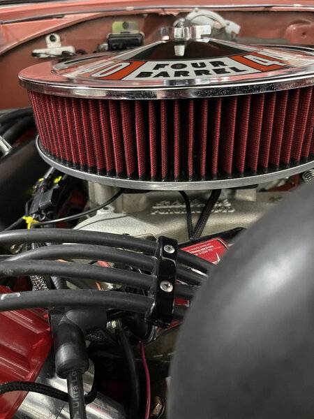

Your base doesn't drop much, have to agree with others that you can still see the carb. Here is my "drop" base.

As usual, you guys have given me some options. I looked at my drop base again and I'm literally touching my electric choke, and only 3/8" of clearance to the throttle linkage. So whatever the reason, I'm not likely to drop any more. Removing the hood insulation, and going with an open top air cleaner is another option. Then of course there is the hood option. I would not cut this hood, I would likely buy a fiberglass hood and install pins, but that's a bloody expensive option. I just finished installing a Flowkooler water pump and Robert Shaw stat, so now I can start looking at air filter options. I won't be driving the car for a few weeks as the pot hole situation here is a nightmare. Hopefully June 1st. Thanks again all.
