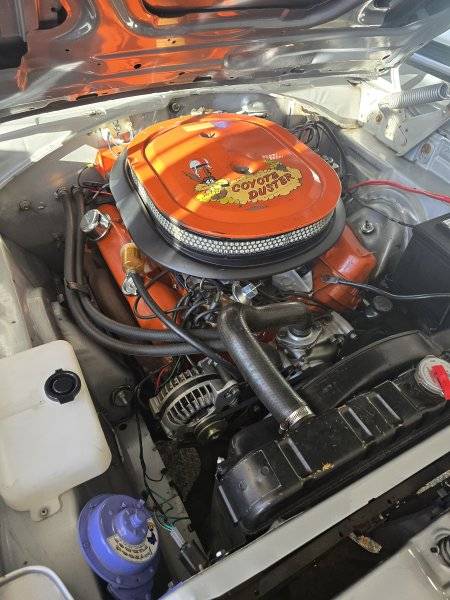

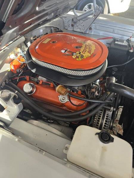

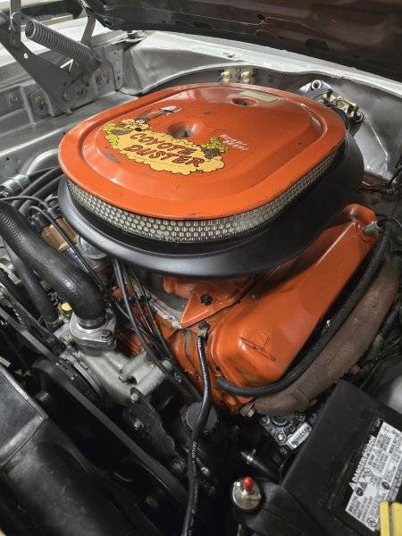

I have a 440 air grabber air cleaner, street dominator, 650 eldobrock carb.
Air cleaner too tall.
If I install a stock intake take with the eldebrock carb will it fit under der the hood?
Can I change the carb and still use the street dominator intake?
Thanks

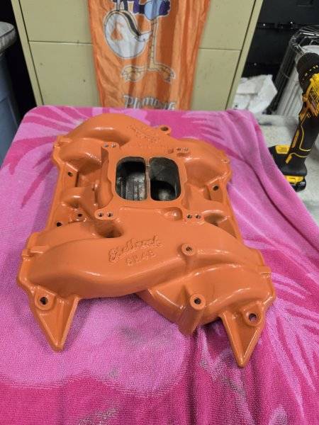

Find a CH4B intake, it will work with the Air Grabber air cleaner…
I have that intake and an edelbrock carb on my 440. The air grabber stuff isn’t installed yet as the rear of the air cleaner metal hits the hood. Just hits, line to line. I am probably going to cut some height off the reproduction 440 base. Not sure how much I need so will have to sneak up on it.
I don't know if an Edelbrock carb is taller than a 4150 Holley, maybe that's enough to make a difference.
I have the CH4B intake. Still tight with the edelbrock. May be that the stiffners on my hood were worked to flatten out a damaged hood though. I think that’s where I’m at anyway.
Didn't work on mine either.
Didn't work on mine. No different thant the holley street dominator intake. Damn.
I put a regular air cleaner on the CH4B and it hits just like the air grabber air cleaner. I guess im going to have to shim the k member.
Air Grabber does have the 440 base.
