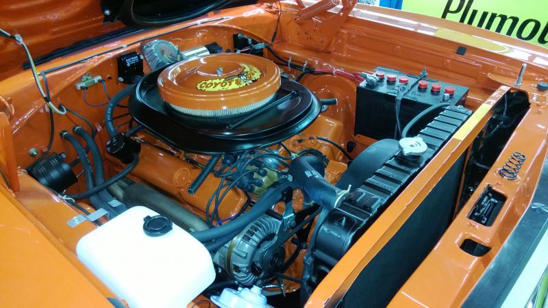

This what you're referring to SlinktRR?

Yes, I have the 69 383 4 bbl oval air cleaner which looks like this:

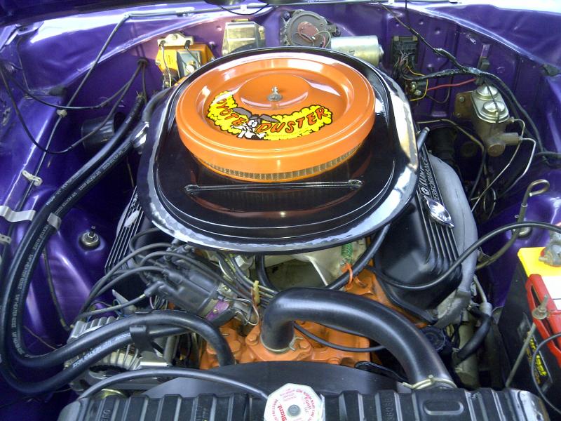

It should look like this for a resto, saw this numbers concours 70 383 N96 RR at carlisle in 2013. It's a california car with emissions tube in the trunk with the dual port breather.
