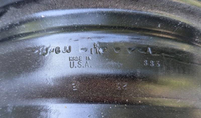

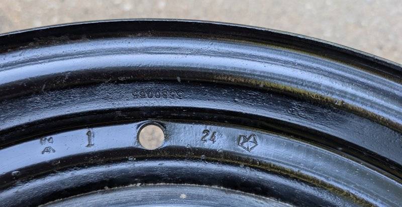

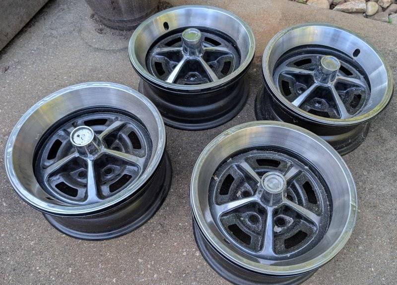

Picked up a set of "magnum" rims off FB for $200 this morning. They're not perfect, but I'm putting wheel covers on them anyway. It gives me options later if I decide to move away from the wheel covers :)

Spin your wheels, or get them spun on a balancer, before you mount the tires on. Something I learned the hard way recently. Sent 4 out for coating, got new tires put on, one was bent. Had to get the extra checked, coated, mounted. No one so far in my area straightens steel wheels. Maybe there is a shop in your area in case you have one or more duds. Many reproduction tires are not round and will really give you problems when mounted to bent wheels.

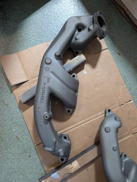

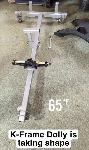

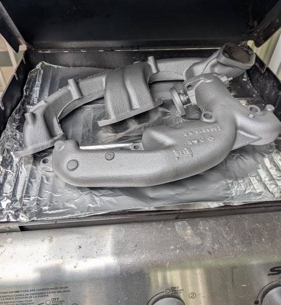

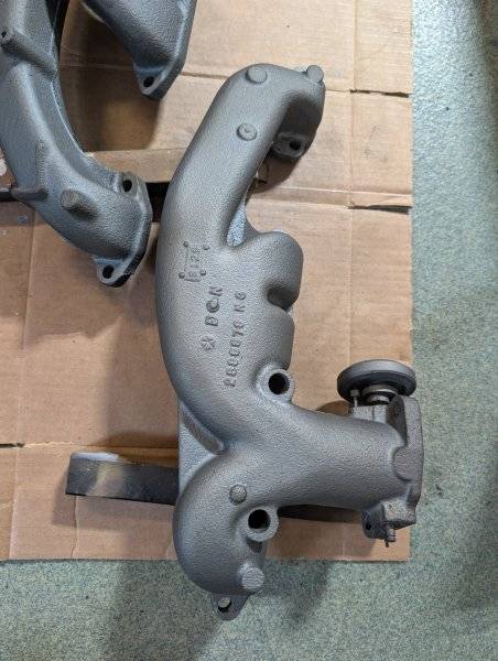

Used KBS coating and grilled up the exhaust headers. Painted & assembled the K-Frame Dolly.
Hit them with SEM clear coat Satin. I'm much happier with the sheen / finish.

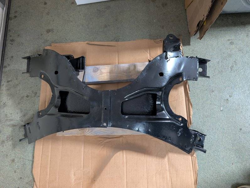

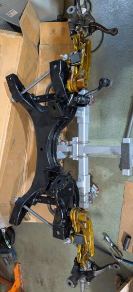

A little progress on the front end and the K-Frame back all powder coated and ready for the dolly.

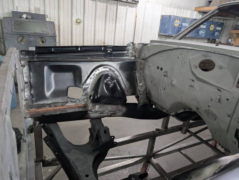

Metal work is getting close to complete. Then the bodywork will begin.

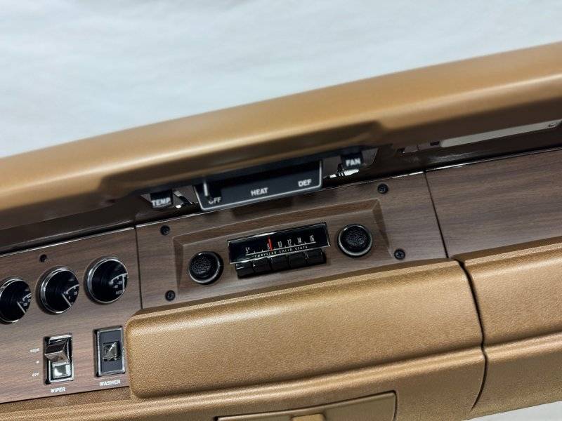

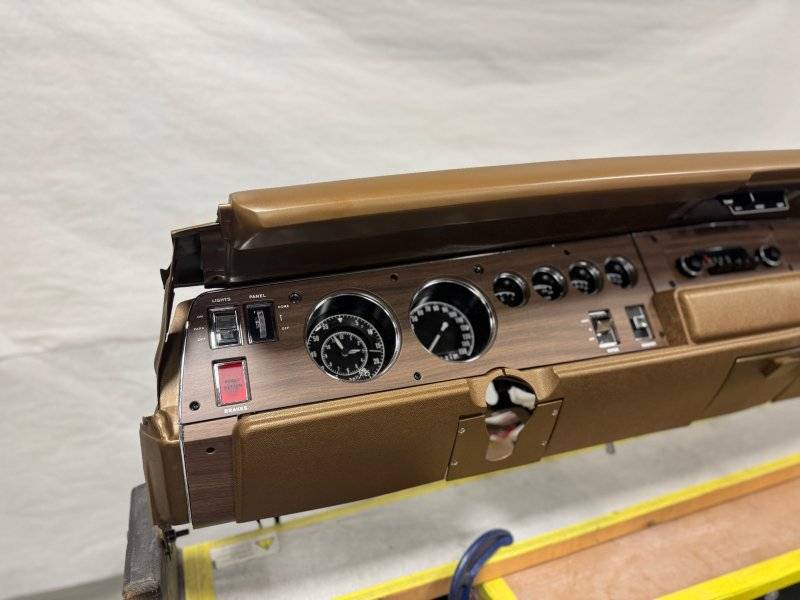

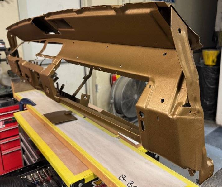

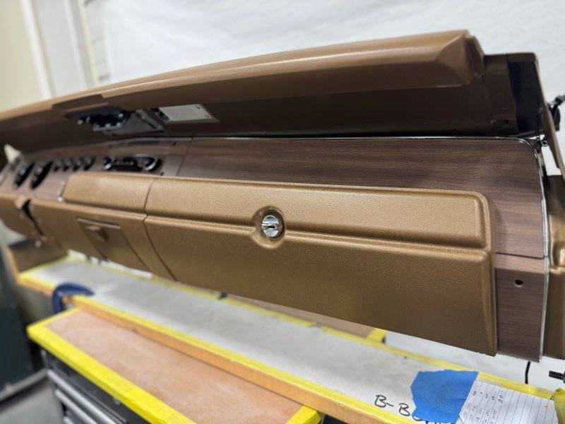

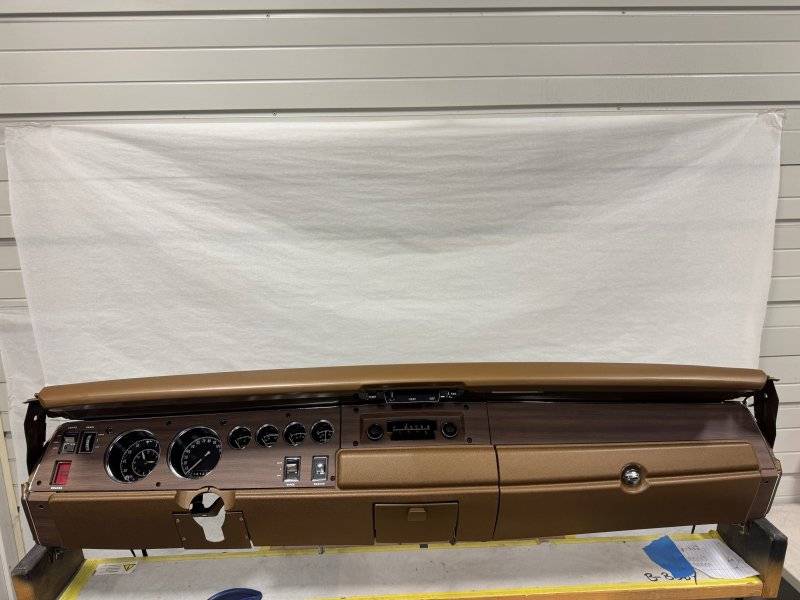

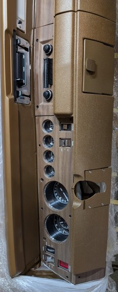

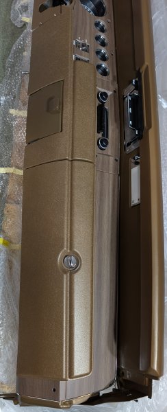

A few pictures of the completed dash from Thomas @ Instrument-Specialties. I think it came out great.
Assembling the front suspension. I did NOT torque down pivot nuts on LCAs nor the front of strut rods.

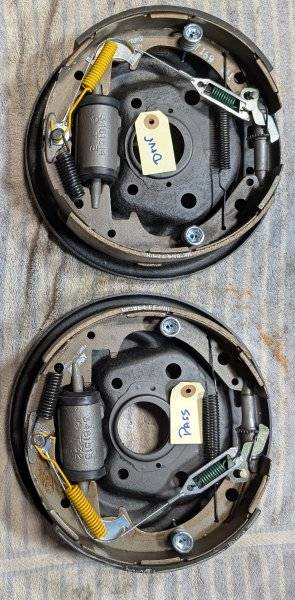

I have to reassemble brake backing plates and get the gearbox on next.

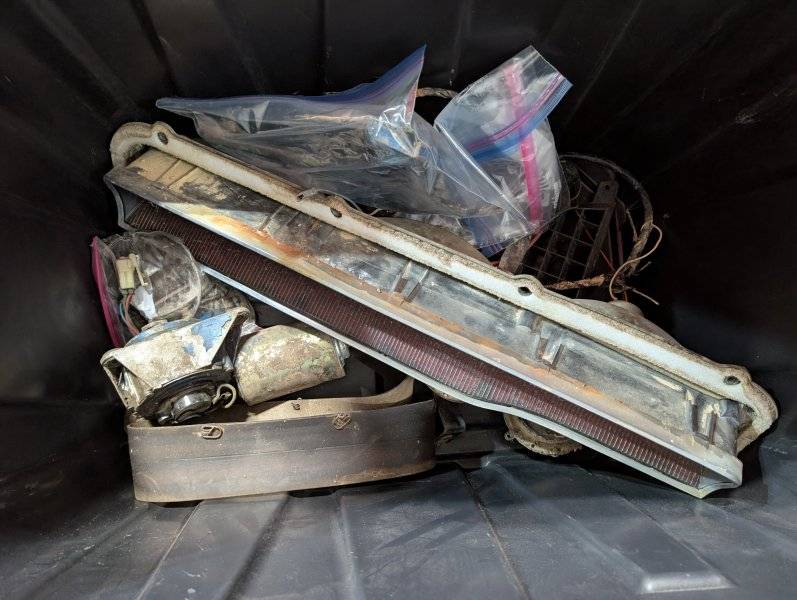

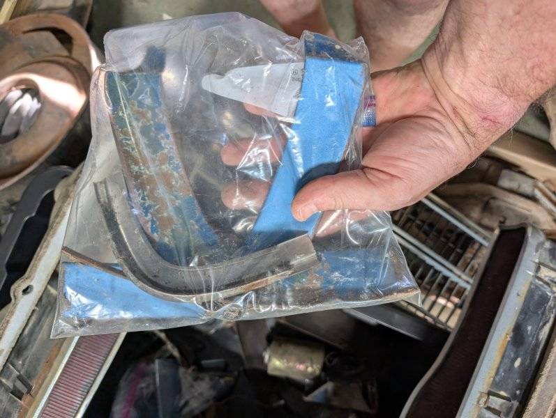

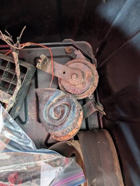

Visited family last week during the 4th and grabbed a few parts off the "parts" 70 Charger at my Dad's house. It's been sitting in a field since the 80s and is worse shape than my brother's that I'm restoring.
* 2 horns (will restore them as I'm missing 1).
* Short headliner bows with clips (1 of my clips are broken)
* Quarterpanel extensions (eyebrows) - extra
* Tail lights - extra
* Middle section of the grille - I need a single vane

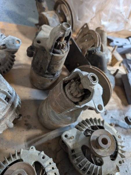

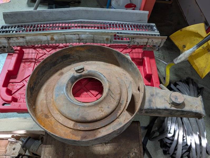

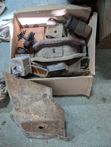

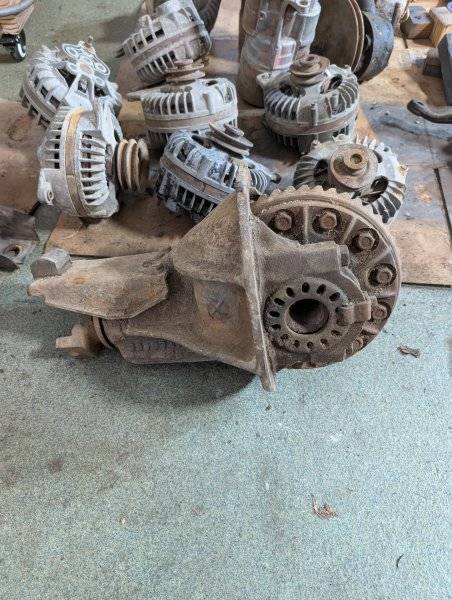

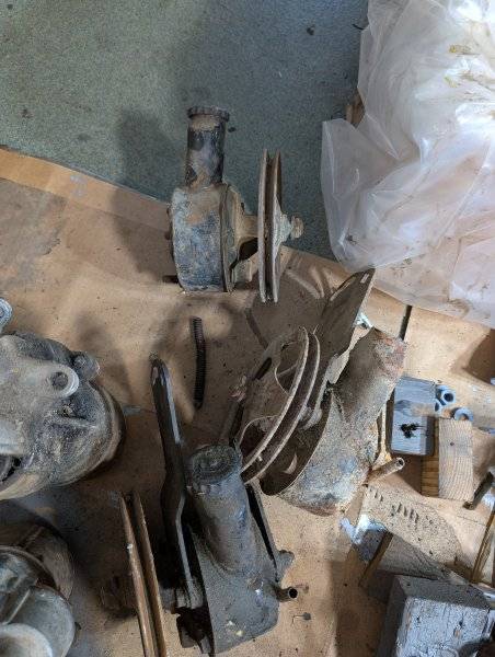

Then I hit the 2nd floor of my Dad's barn looking for more stuff that my brother hoarded. I came away with the below parts - will clean them up and add to marketplace with the "extra" stuff above.
* Wiper motor
* Motor.mounts
*Transmission bracket

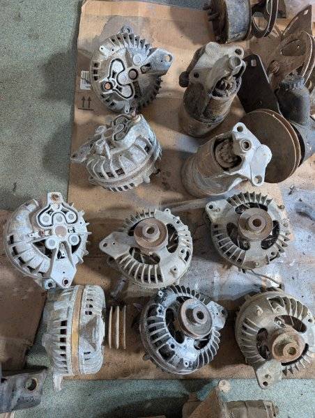

* 3 power steering pumps
* 2 starters
* 8 alternators (why he had eight I'll never know)
* Air cleaner body (no lid)
* 741 chunk

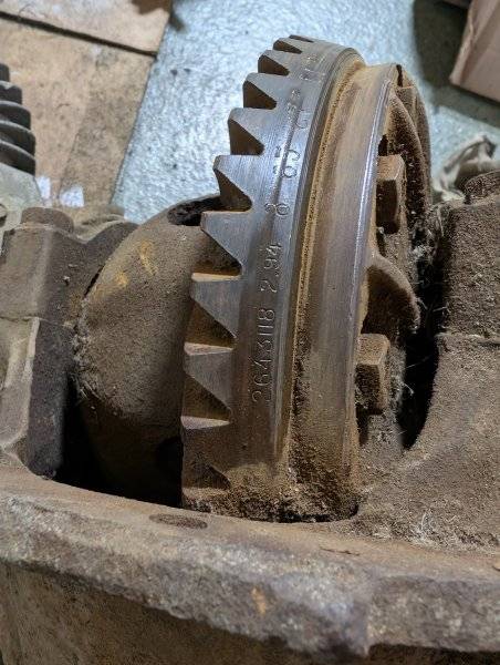

That's all I had room for. The parts car has a power steering gear box and possibly a dana rear end. There's there's another complete axle (489 case)that I believe is from a 72/73 charger (based on hub 2 hub dimensions).

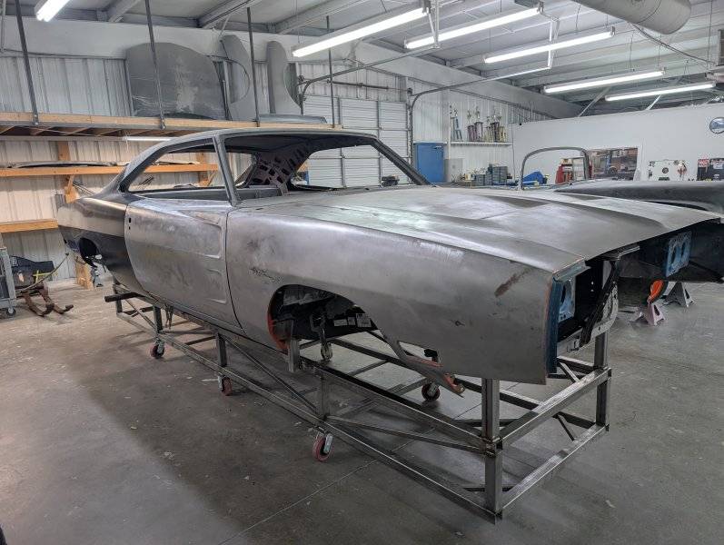

Slow progress as they weld everything together. I do want it to be strong/stable, so I'm glad they're taking their time.

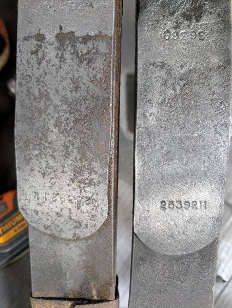

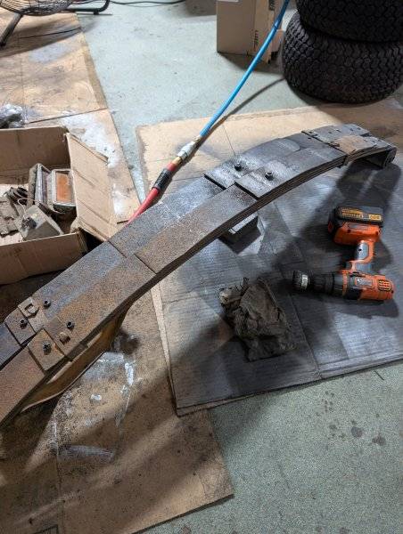

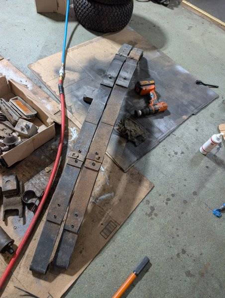

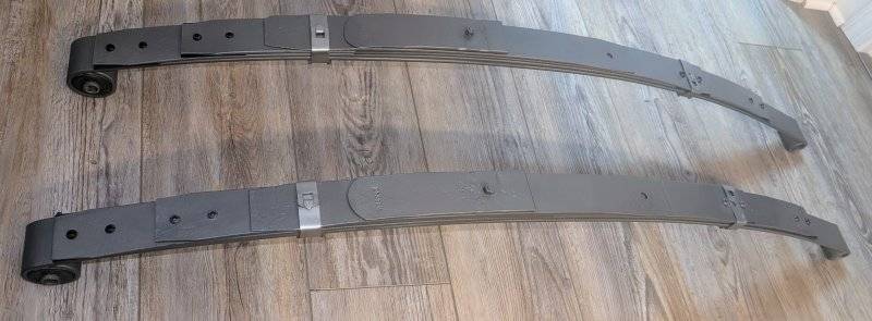

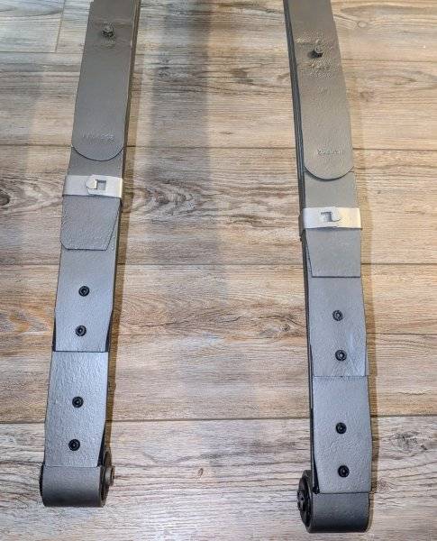

About a month ago, the shop doing my metal/body work called me and said that the leaf springs on the car were not the same (the 2 were reportedly different lengths). They were trying to check the final fit before welding the rear frame rails, so I sourced 2 used ones based on the manual (1970 383 4 BBL) as part number "109", and they lined up perfectly. The shop is done with them, so I picked up the rear axle and leaf springs (both pairs) yesterday and brought them home. I wanted to check part numbers on the ones that were on the car when I got it, so that I could sell them (I don't like mysteries). Well, low and behold, they're not different, they're the same part number (211).
They do seem like different lengths, but I'd guess more do the curvature. They sat under a car with bad frame rails for 40+ years. I've been watching videos on re-arching them using a press and DYI JIGs. Anyone have long term success with that? I have the 109s that fit perfectly, so I can try and re-arch the 211s to match. Thoughts/ideas?
Assembling the front drums. Will press new bearings into front hubs tomorrow.

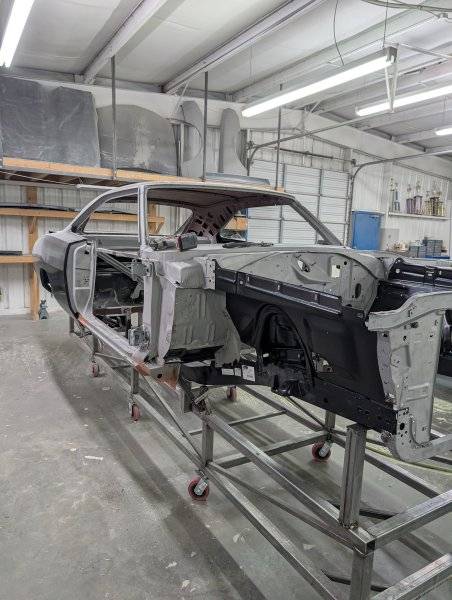

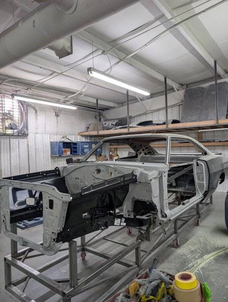

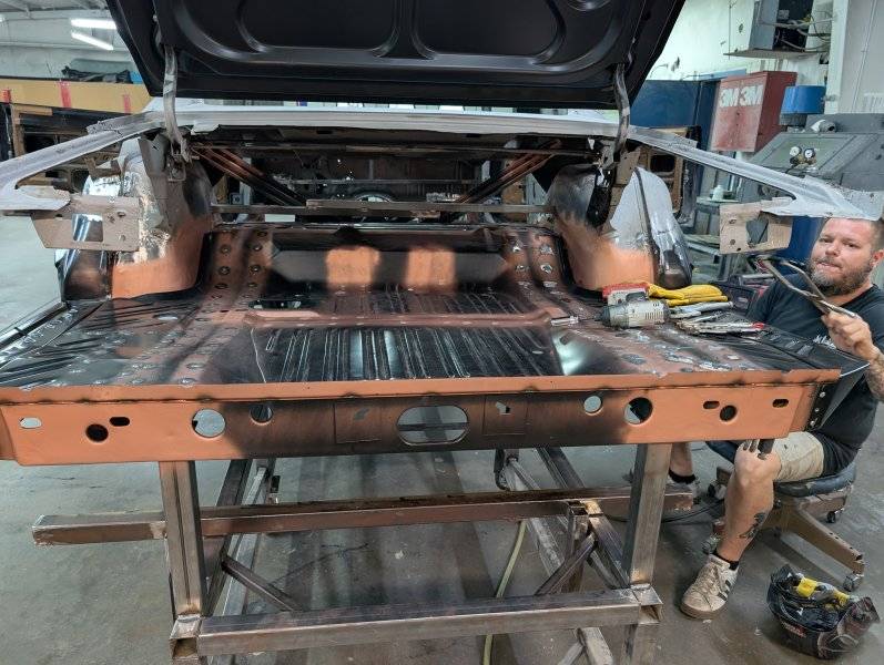

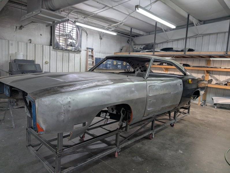

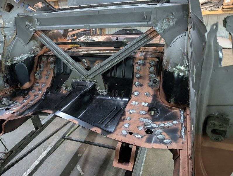

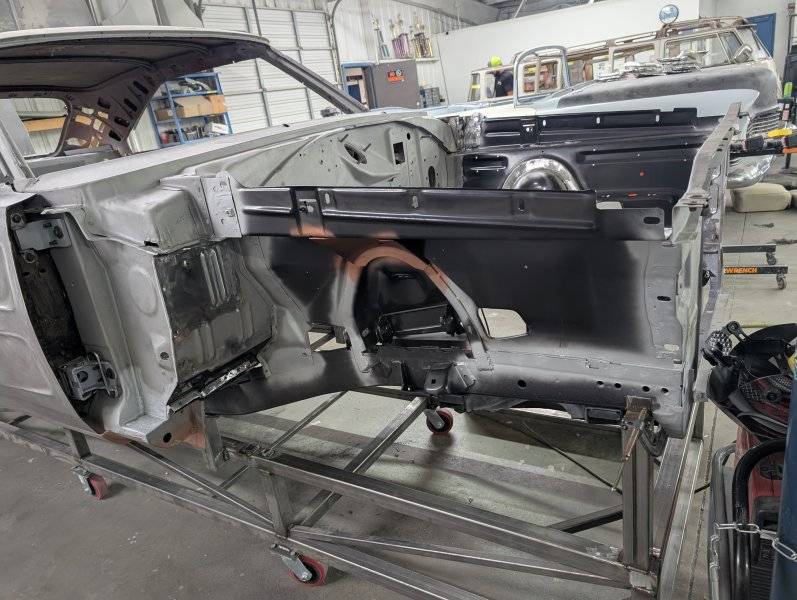

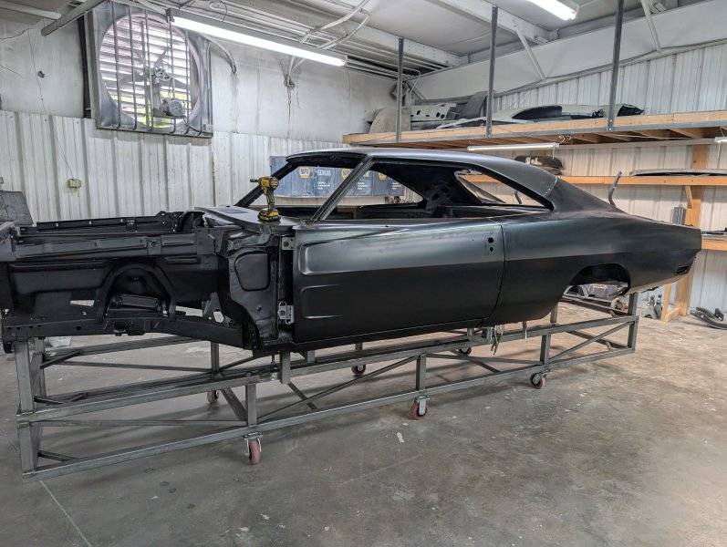

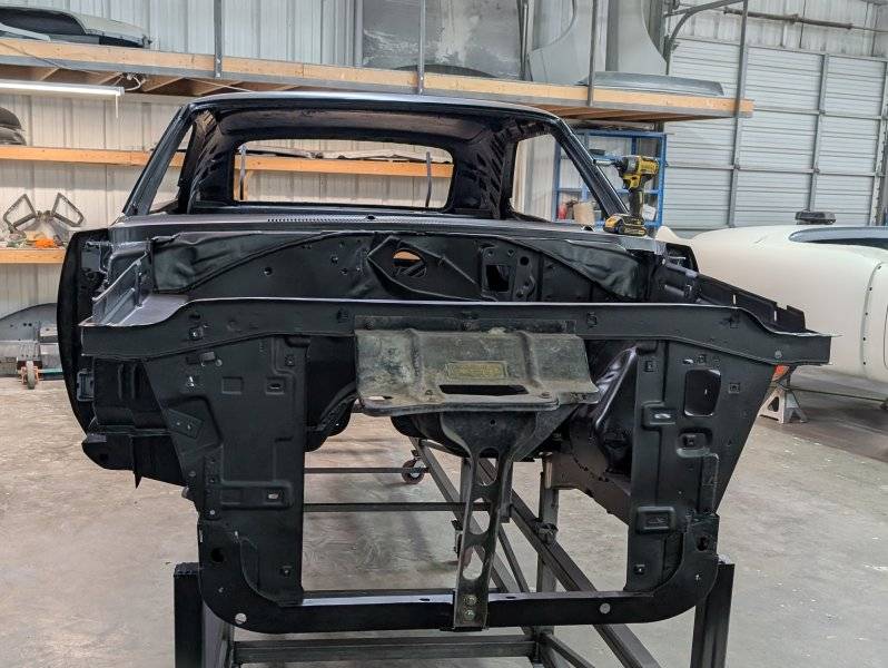

Floors and inner fenders welded in place. They need to do some grinding to wrap up the metal work.

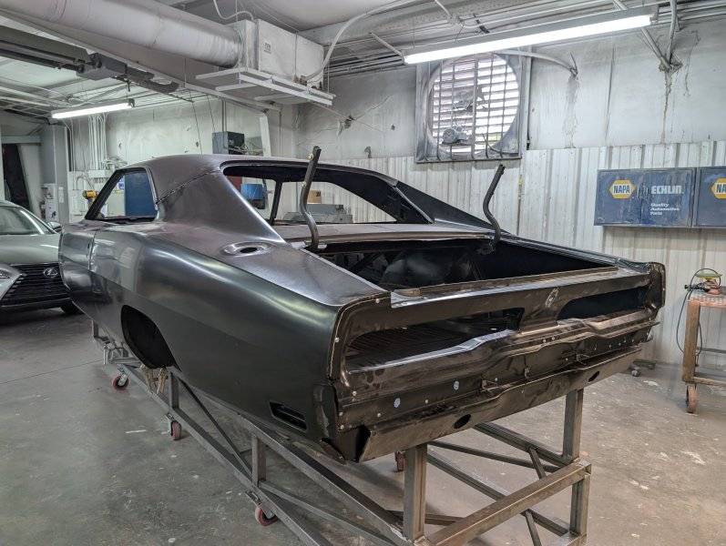

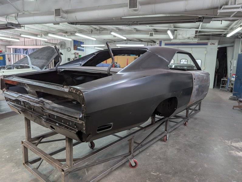

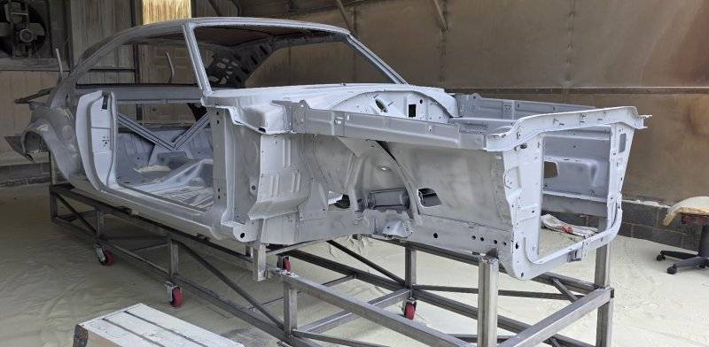

Major metal work is done - there was a lot. Car is blasted & primed - they're welding on the quarter panels next. Also received my steering column & dash back from Instrument Specialties - keeping them stored in my parts room (aka bedroom we don't use) for 4-6 months until the body is complete.
Looking forward to seeing the quarter panels on soon and the never ending blocking & sanding starting up (black car so it will take a while).

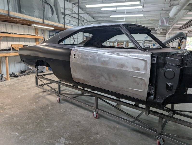

More pics - ending metal work and moving to bodywork next week.
