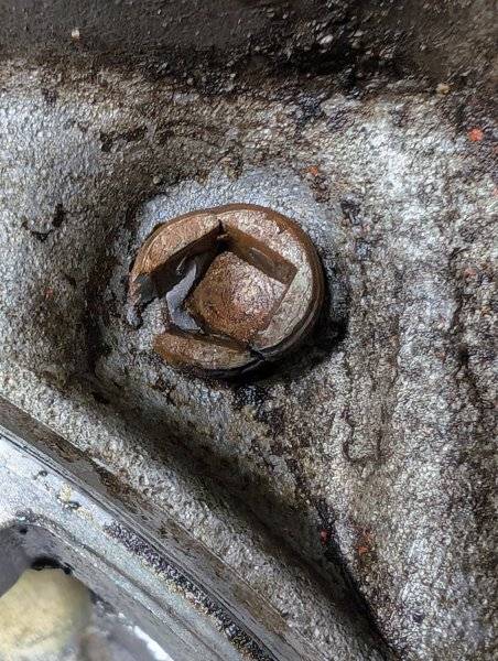

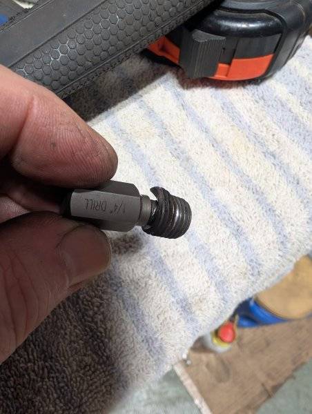

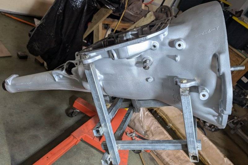

Well the disassembly wasn't bad. Haven't really started the rebuild of all the components. I'm going slow and steady as it's my first time I had one plug break off the head (holds the kickdown lever pin in place). Spent several hours carefully drilling, using an easy-out, and applying heat to get it removed

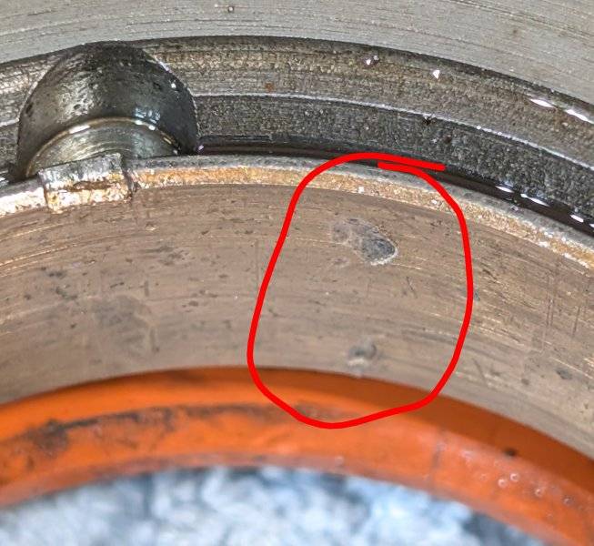

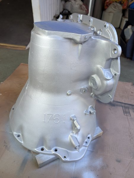

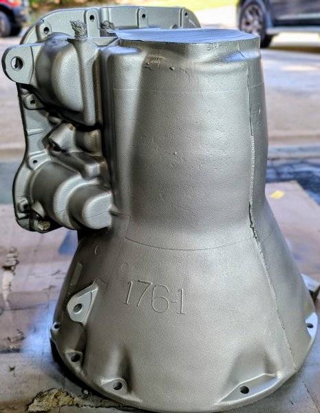

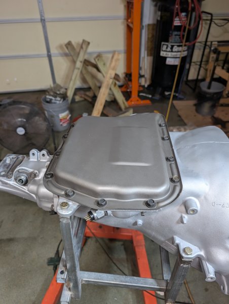

Got the housing cleaned and painted Started on pump and the bushing is nicked. Ordered the bushing kit, so will need to wait for it to arrive. The reaction shaft bushing is discolored, but doesn't feel worn/grooved.
I'm not pairing the inside of the bell housing - no one should see that.

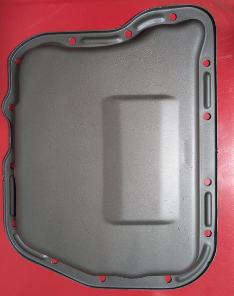

Housing, pan and pump are cleaned and painted. The pump and front clutch pack are disassembled, but didn't want to disassemble too many subassemblies at once. The bushings should arrive today, so I can get back at it.

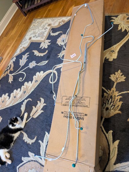

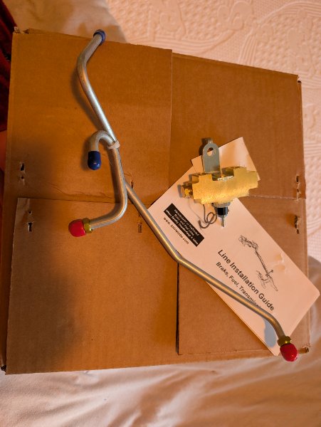

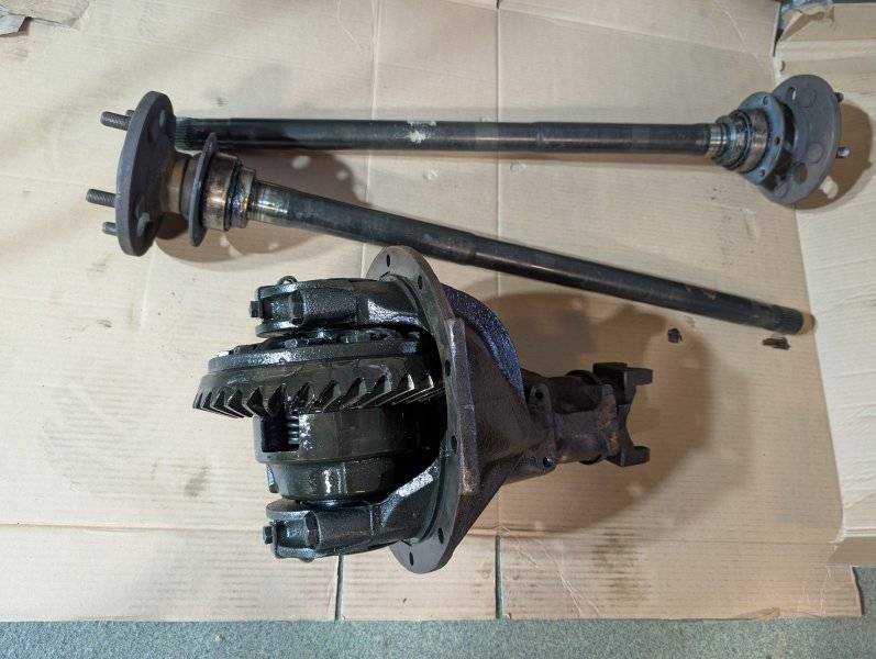

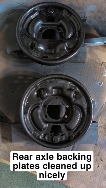

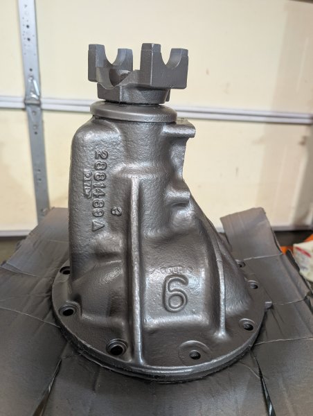

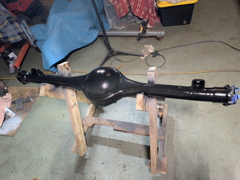

Also ordered the brake lines (steel OE) from Inline Tube. The rear axle / diff is next after I rebuild the transmission. I need to mock up the brake lines with the missing/replacement brackets on the rear axle and weld them on while it's empty and before paint (or power coating).
