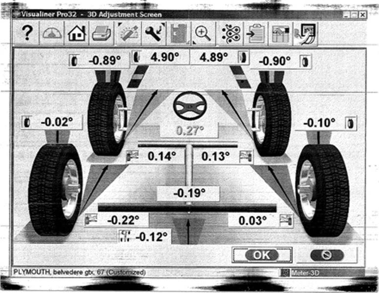

Yep,... That's what I used to set mine up in my Barracuda. Moog offset bushing in the UCA help get more caster, which you want with radial tires. Mine came out at just under 5 degrees of positive caster. More than I would have asked for per the Skosh chart on the Allpar link, but in fairness, I asked them to give me the most caster they could. Camber is set on mine to about -.89 degrees. I told them I wanted .75 - 1 degree of negative camber. My toe in is about .14 Degrees in on each side. See below for my alignment printout. Car drives straight and steady

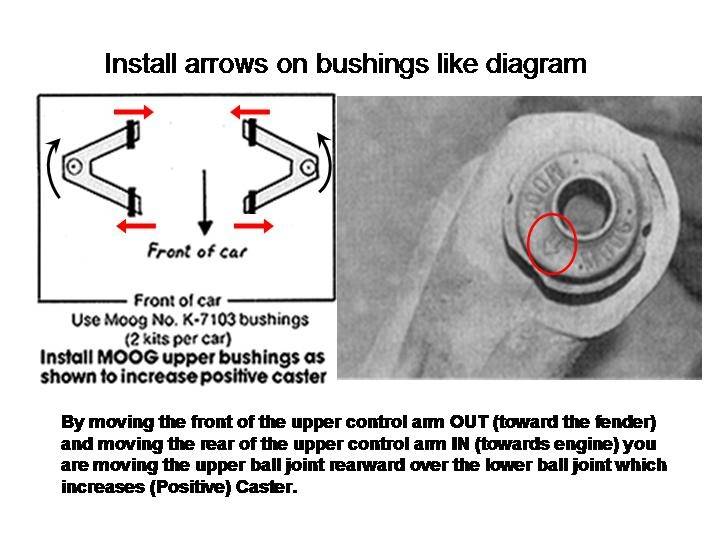

K7103 Moog Offset Bushing that allow for more positive caster.
If you installed them like the instructions in the package they might not help you much. The Moog intention of the bushings are for rusty cars that have sagging frames that bend inward over time.
The "trick" is to install them like this diagram below and ignore the Moog instructions. The arrows will be pointing opposite directions front bushing to rear bushing.
First make sure you set the ride height first to what you want. Factory manual alignment specs are no good for radial tires, they only work if you use bias-ply tires. For Radial tires, Camber -.50 to 0 degrees, Caster as much positive as you can get up to 3 degrees and toe in 1/16th to 1/8th inch. Car runs down the road straight as an arrow now. You will be limited to what you can do with stock A arm bushings, but if you have the Moog off set A arm bushing you can tweek it a little more.
