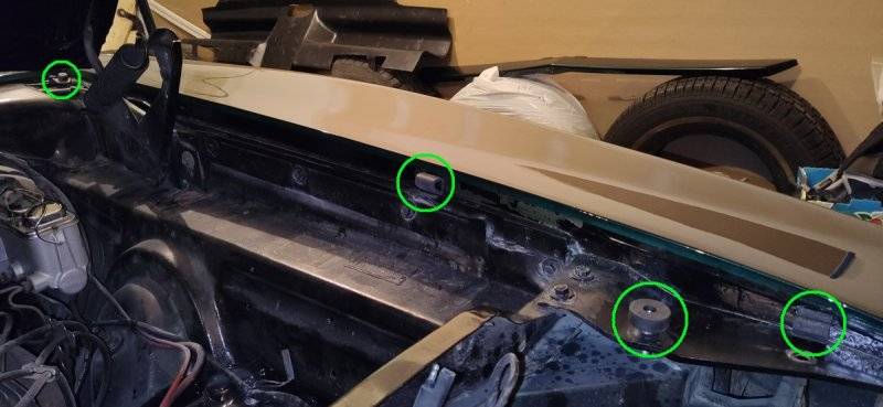

I'm installing new body bumpers from a kit I bought and it would be really helpful if someone had pics to share of the various locations and orientations. I got the 8 under-hood bumpers installed, but it took some trial-and-error to figure out the correct bumpers, and mounting positions, for the 4 bumpers that press into the rectangular slots along the fenders towards the front of the hood. The 2 big round ones and 2 small ones at the front and rear hood corners were easy enough, but there's several more and it would be helpful for me and others if someone had some pics to show where the rest go. Thank you!

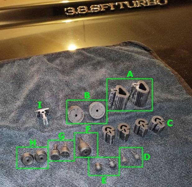

Here's what I have left after installing the ones under the hood; the 2 big round ones at the front that are bolted in, 2 along the fenders on each side and one at each corner of the cowl. I haven't done the doors or trunk bumpers yet, nor any on the interior, like the ashtray and glovebox door bumper. I may have dropped the other "F" somewhere down in the nether regions above the K frame, of course the damn thing didn't fall down to the ground...
The 4 A s go in the sides, the 2 in there are upside down.
B trunk lid
C doors
E, D , ashtray, glove box?
F lic plate?
I pedal stop?
H, G, ...
