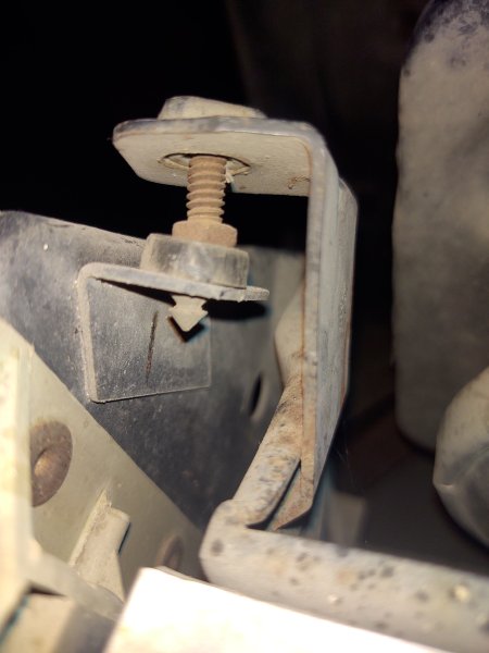

Headlight door bumper (1 per door):
Mine are the originals (old, worn, and somewhat deformed) to my car and measure 0.5" diameter and 0.16" tall.
The tall dimension above doesn't include the nib that sticks through the bracket.
Aft fender bracket: 1 per fender
This bumper has a long tail on it. Again, original to my '70 Charger.
Pardon the dust remnants from Texas sandstorms.

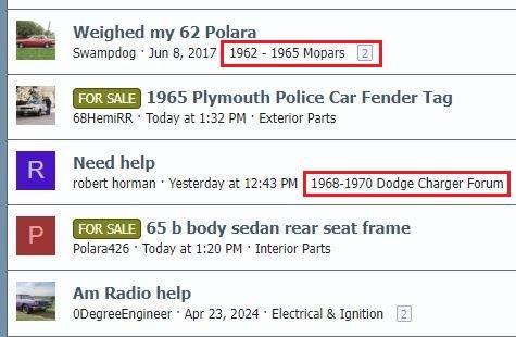

To everyone following this thread.....a useful tip when asking for advice or assistance is to start the question along these lines.....
"I'm working on a 69 Dodge Charger with ........ I need help with these parts....." (as an example)
This has been a tried and proven method for the majority of people here. :thumbsup:
This may be equally helpful...for those who only view New Posts. As pointed out by RemCharger:
You've been here five minutes and you know how everything works....good for you. :thumbsup:
I've been here a bit longer, and if you could see the amount of dumb shite that the Mods have to move, alter and delete, it would blow your mind.
What I wrote above stands as good and sound advice. Anyone can easily overlook what section they are in at times.

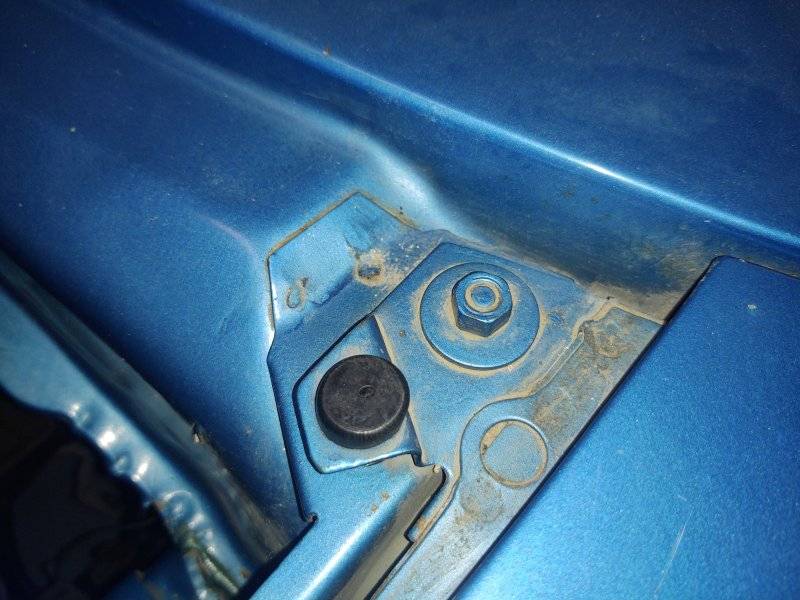

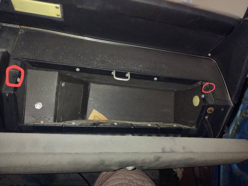

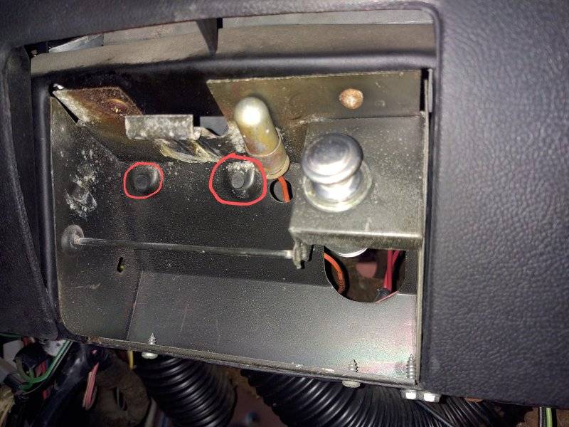

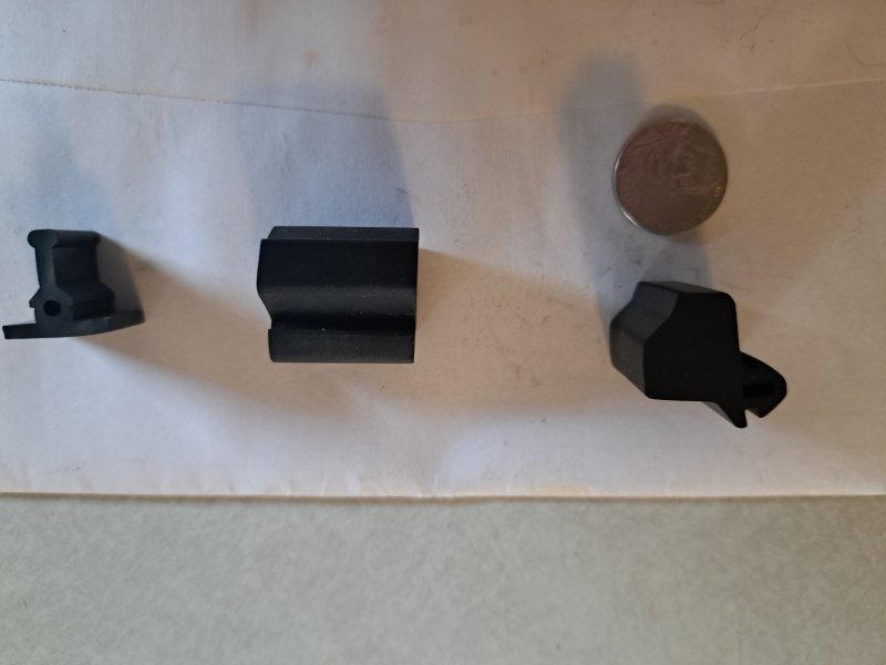

Here's an update on the body bumper situation. Recalling my original image, I got everything installed except the 4 small ones for the ashtray & glovebox and the T-shaped pedal stop bumper. That left 2 x H, 2 x G and possibly 2 x F (one that dropped and vanished somewhere below the battery tray). I'm pretty sure I got the kit from Detroit Muscle Technologies, but it was years ago and I just had the baggie with nothing numbered or marked other than a product number.
Mopar B Body 70 Charger Body Bumper Set BBK5A
Anyway, the holes for the rear license plate were all too big for any remaining bumpers except 2 x H and the single remaining F. The 2 smaller G bumpers were too small to fit there. They also don't look correct for the headlight cover bumpers because they're at least twice as thick. My original ones there are still in decent condition so no need to change them out.
Have I installed the rear license plate bumpers in the correct holes? I assume so because nothing I have left fits that big hole. I also have misplaced the square yellow plastic license plate bolt inserts...hopefully they turn up, but this car won't be driving for at least another year.
I have my front license plate bracket removed, I haven't used it for years as it's not a requirement in Alberta, Canada and it looks ugly anyway...so if I'm missing a bumper for that, no worries.
I could only peer between my license plate and rear valance to see the three bumpers. Yours appear to be inserted into the correct holes.

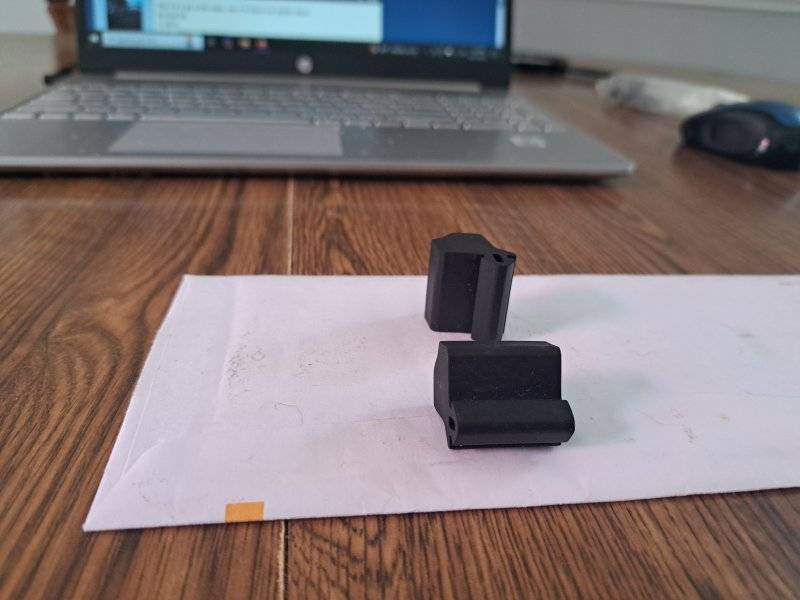

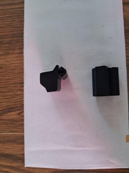

these came in my kit also anyone have a clue? And were does/ I /go?
