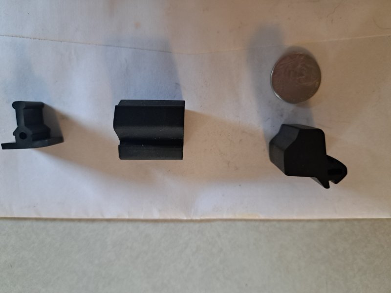

Im thinking they added those in the kit by accident. Im cluelessMan....beats me!

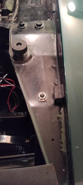

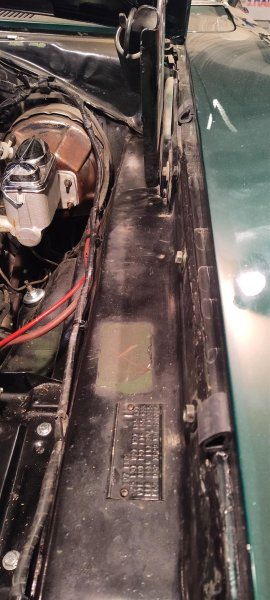

so 3 total on each fender?There are 2 slots for hood bumpers right beside the hinges where I almost missed them until I looked closer. The weird-shaped ones in your picture go in the front-most slots, near your headlights, and the 2 pairs of rounded ones go in the 2 slots along each fender, with one partially hidden beside the hinge.
View attachment 1910456 View attachment 1910457
Yep. If you look at my earlier posts, I had 2 spares of the rounded ones (A), because I missed the slots beside the hinges. So the 4 rounded ones go rearward, the 2 weird-shaped ones go at the front. After I adjusted the nearby hood bump stops, my hood closes nice and smooth.so 3 total on each fender?
Does it go downward, Meaning angle ? Is this a charger only because I do not have these on my Bee,no holes.There are 2 slots for hood bumpers right beside the hinges where I almost missed them until I looked closer. The weird-shaped ones in your picture go in the front-most slots, near your headlights, and the 2 pairs of rounded ones go in the 2 slots along each fender, with one partially hidden beside each hinge.

I think you're right about the T one, my car is an auto so it's unnecessary. The weird-shaped one slots in pretty obviously, there are right and left sides for that bumper. Doesn't your Bee have the same 3 rectangular slots per side, along the fenders?So I was told that the T one is for the up bump stopper on clutch pedal. Letter I in pic

No I was informing the guys since no one knew were it went. I thank you for all your help Mark.Are you doubting my expertise?

True, but I still think there would be more than just 2 slots for hood bumpers, one on each side. If there were only two slots, and they were located right at the front near the headlights and round adjustable hood height bumper, I'd insert the weird-shaped ones there. I tried the rounded ones in front and the weird ones more rear-ward and the way I installed them is the only way the hood would come down properly. The fact that there's only 2 of the weird ones in the body bumper kit means they must go somewhere different than the other four rounded ones.The charger hood is a big long bugger compered to a coronet.
not on 70 Bee or Mikes 68 and 70 RoadRunner.Let us know what you find out. I'd find it very odd if a Super Bee's hood bumpers along the fenders would be any different than a Charger's.

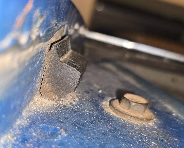

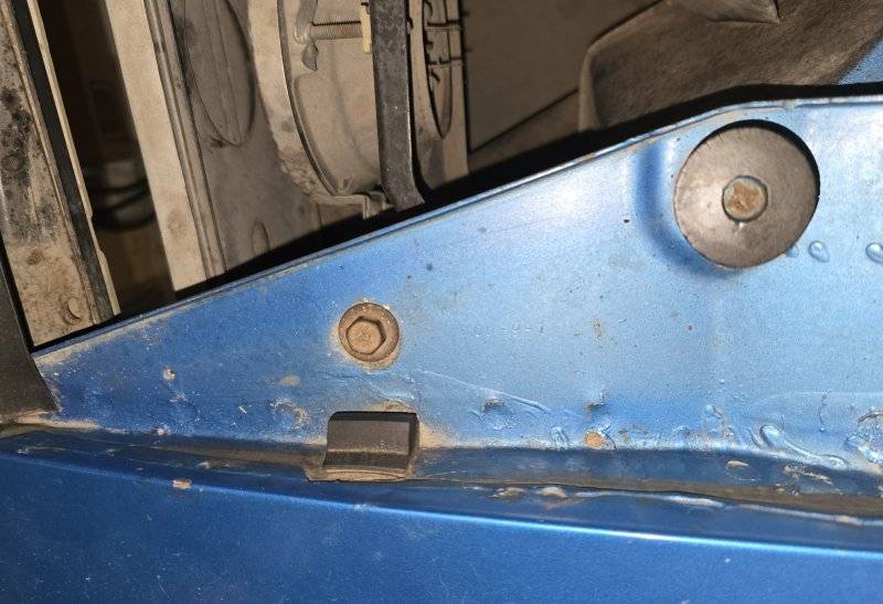

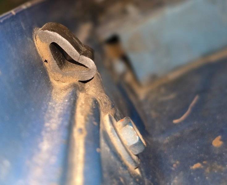

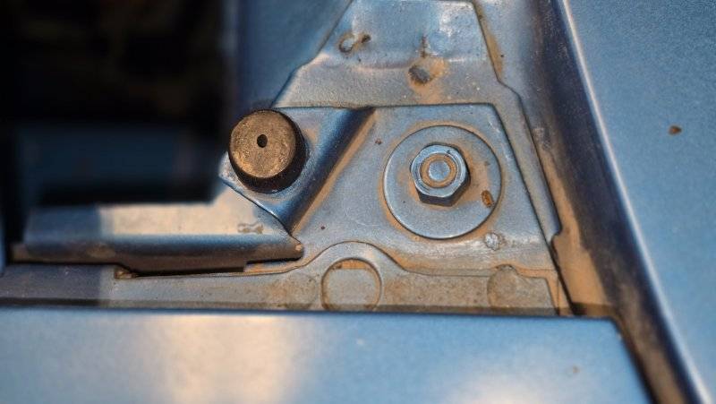

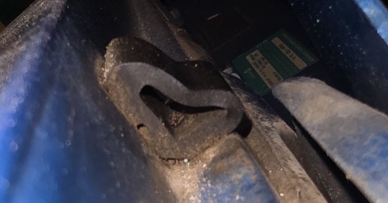

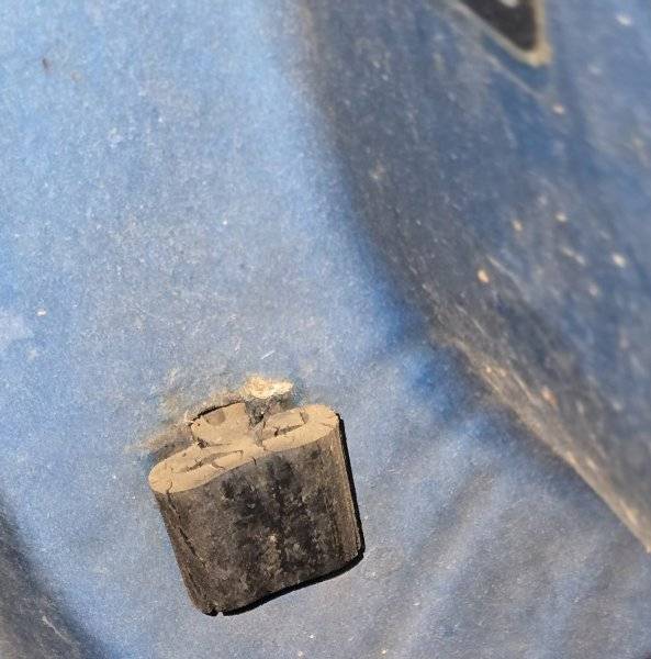

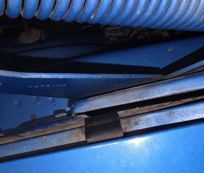

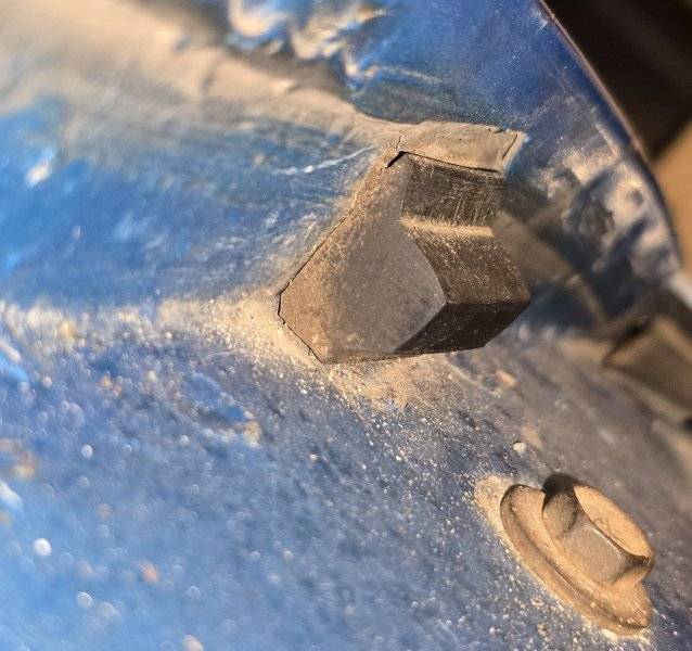

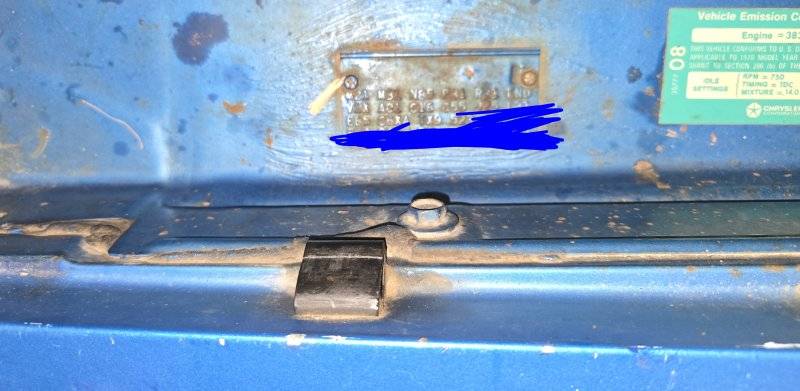

That's exactly how mine are, for the hood bumpers.Three wedge-like bumpers along each fender of my '70 Charger. Also, one round bumper near the forward wedge and one smaller round bumper near the fender & cowl.
All pictures below are the left side of car; right side is symmetrical of course.
Forward wedge bumper & round bumper:
Middle wedge bumper:
Aft wedge bumper:
Aft round bumper near rear corner fender/cowl:
Forward wedge looking forward (2 pics):
View attachment 1911115View attachment 1911116
Middle wedge looking forward:
Aft wedge looking forward:

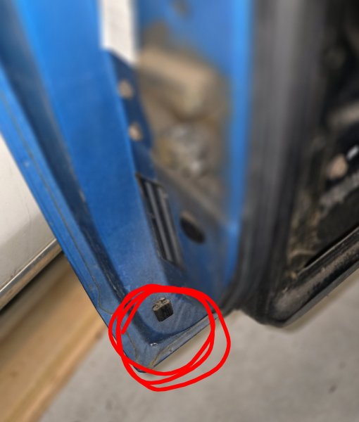

Door bumper at lower back corner (2 pics):
View attachment 1911137View attachment 1911138
No trunk bumper pictures tonight. Let me know if you need them too @davek
