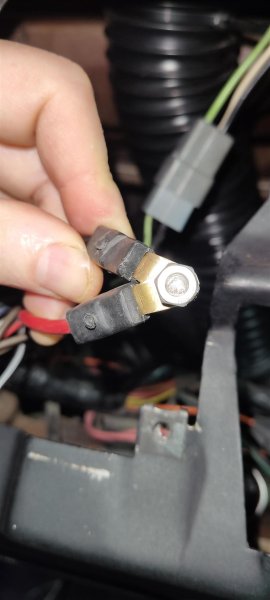

Since I have my instrument panel out and having read hours of threads on ammeter gauge bypasses, and seeing as my car's wiring is all fortunately intact and not full of scorchies and melties, I want to do what I can to reduce a future fire risk. I already have the battery terminal disconnect installed. I shunted the leads to the ammeter gauge as shown. What else must I do to avoid future disaster?

Thanks guys, I forgot to mention I'll be installing a voltmeter to substitute from the ammeter, which will be non-functional. Fortunately my wiring is sound, bulkhead connectors are good, and I believe the only non-stock wiring was done by myself for an aftermarket stereo and the alarm system, which I've removed all evidence of.
From what I see in the pictures your wires are like new.
I think you would have been fine with the original setup.
