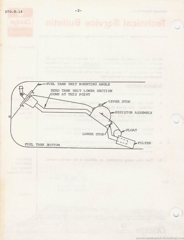

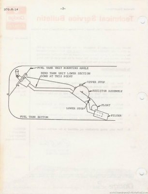

A guy on Moparts sent me a Dodge TSB that was printed in November 1970. It pertained to the very issue we have often read about: Gas guage not reading full when tank is full. It showed how the fix is often as simple as bending the fuel line on the sender so that the filter rests against the bottom of the tank.
I took my sender out today and laid it on the table. I took a Sharpie and traced the outline on a piece of cardboard. I then bent the 3/8" line several times until the filter end sat too low and caused the top side of the mounting flange to sit off of the tank. I took some of the bend back out until the flange fit right. THEN I pulled it back out to check it against the original shape that I outlined. I had actually bent it 1 1/4" !
The sender tested at 74 Ohms out of the tank empty and 11.8 full.

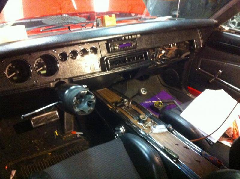

I just had an epiphany reading this old topic...nearly everyone talks about needing to drop the steering wheel to R & R the instrument panel, when all you need to do is pull the steering wheel. D'oh! I wish I saw this topic weeks ago when I pulled my instrument panel, I wouldn't have had to remove a bunch of fasteners, yank around on my steering wheel, replace the column-to-firewall gasket, etc. etc. I need to remove my steering wheel anyway to put on a new leather wrap I've had in my stash for years. Things would've been so much easier! :BangHead: :)
That is a flashback seeing that picture with the automatic transmission shifter there!

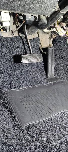

I also noticed the position of your gas pedal to the heel pad was similar to mine. The way my ACC carpet was molded, there was no way in hell I could've positioned it so the gas pedal would've been in the "correct spot" at the top right corner of the heel pad. I would've had to shove the carpet an extra 2 or 3 inches up the firewall, trim that much left-to-right because it was already pressed up against the pedal brackets, and nothing would be fitting anywhere else where it was molded. Maybe we both got ACC carpets molded this way?
This is the best I could do with mine:
