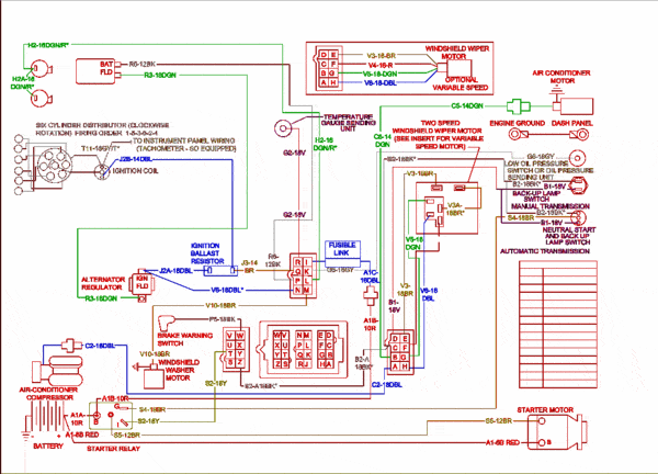

Take the alt in to a place to test it. If its good, swap another reg in. Before you do either, really examine the wiring. If you are certain the wires are good, not much else to the system. And the ammeter is good, and wires are good?
Make sure your ammeter is not burnt out.... If the ammeter is bad it won't charge. Bad ground @ VR, check & remove screws clean area....Check for 12v at alternator stud.....

You mentioned changing to the electronic voltage regulator ("VR") and the two phase alternator, have you done this already? If so, did you scrape the paint off the back of the VR so that its bare metal and same with the mounting holes on the fire wall? Need a good ground.

Thanks for replies.. The amp gage is eliminated my dash wireing is another issue it self.. 2 wires that goto amp gage are tied togather.. Prolly the regulater again im guessing.. Thanks again
