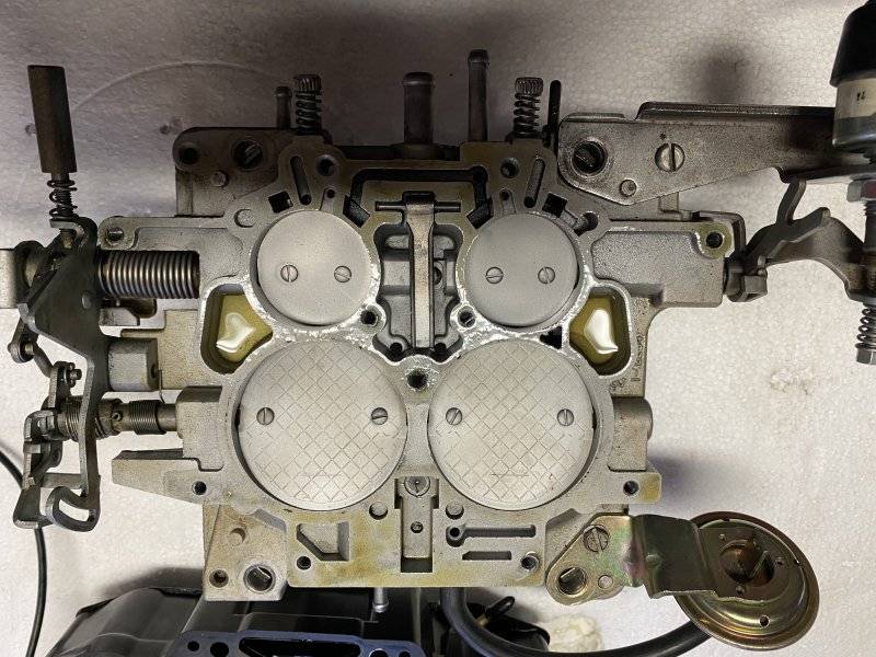

Have my Thermoquad apart and with a suspected internal fuel leak. What can I use besides gas to fill the wells to test for leaks.

If its all apart you could use water.
Can't use water surface tension. Fill a glass of water then very carefully, you fill can it above the rim. Glass has to be dry around rim.
............What can I use besides gas to fill the wells to test for leaks.
Even a bowtie forum may be useful on occasion....... :eek:
If you're worried about the smell in the house, you can also use low odor paint thinner.
As Fran pointed out. Water won't show leaks due to surface tension.
Just use gas..... :poke:
Will use gas and do it outside.
FYI when I opened it up found gas in the two indentations on throttle body where the bumps of fuel bowl sit. See photo.
