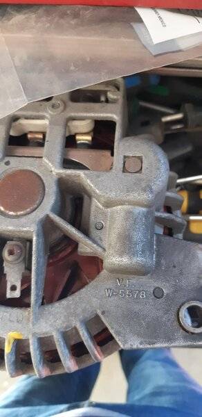

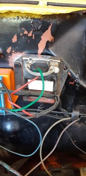

My VR is quite a bit different than the one you suggested moes, here is what I currently have with the only number I could find on the old alternator.
Perhaps my old VR does not work with the new alternator Ive installed? Just want to be sure.

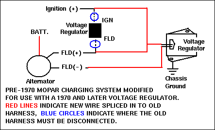

looks like some one has converted over to electronic voltage regulator conversion. Your new alternator will work with the 70 system

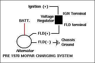

this is what your 67 should have from the factory

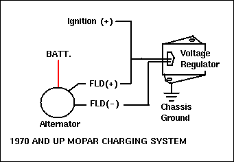

here is a diagram to check to make sure it is wired correctly
