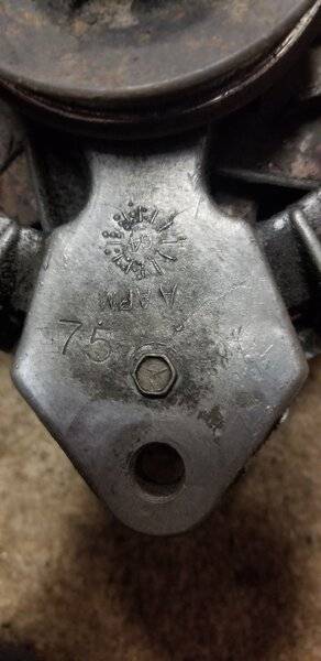

Before I return this for the core charge, is this alternator of any value or save for a rebuild?
Yes keep it. That’s never been blasted. I have all mine done at a local rebuild shop. You then have original cases and they are good units with no problems and you kept your money local.

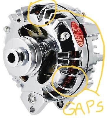

The one you buy at the auto zone might be off a front wheel drive mopar. They have a narrow band in the center and the gaps in the fins. This is from a front wheel drive not a muscle car.
There’s people that care about the date codes on them. I don’t, but it might be worth something to someone.

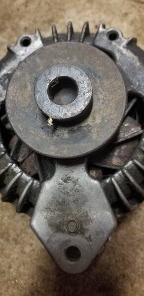

Is that a 65 in picture with pulley? If so probably the original alternator, don't let it go.

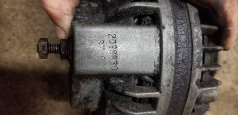

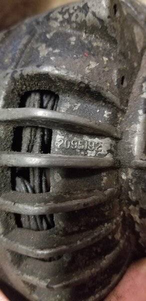

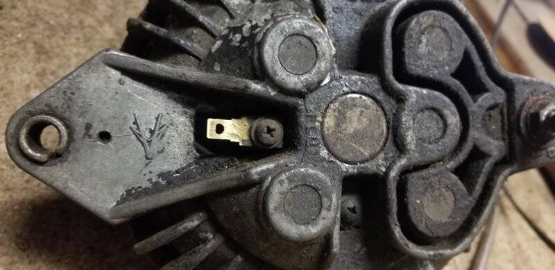

ABSOLUTELY DO NOT TRADE IT IN.....correct on the date code....the 37th week of 1966. The second pix shows the origional Mopar assembly number and the assembly date. The first pix shows the sheave's (pulley) part number (just barely visable). The end view shows the old "Forward Look" logo + the other pix shows the casting number and casting number "clock" as to when it was cast. After disassembly and cleaning and reassembled with new parts, it will look better than the chromed unit and work as good as new. Just my opinion of course. To someone doing a numbers matching restoration this will be a great addition to the effort.......put in the FOR SALE section and state the price....
