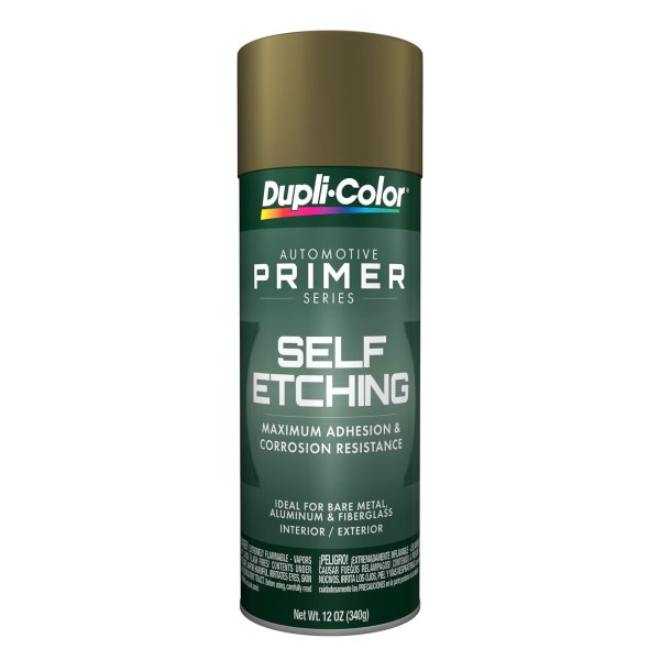

Aluminum requires an etching primer for best results. Local parts store should carry it.
Hope you used this? It doesn't say high temp.
I have and it held up fine. Does your intake have a exhaust cross over? That would be a real hot spot for any paint. Many don't go to the extent to use an etching primer and the paint holds up fine as long as it's really clean. I use it because it's aluminum.
The etching primer is only applied with a couple of thin coats.
