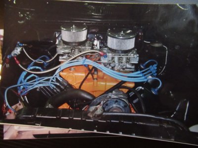

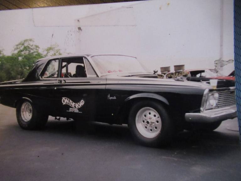

IMG_4594.JPG 3.12.18 032.jpg IMG_4628.JPG 3.12.18 198.jpg Oldies 001.jpg Oldies 005.jpg Oldies 022.jpg 5.13.15 005.jpg IMG_9960.JPG
If the budget allows aluminum heads with some massaging,new pistons and cam would make it an animal!
It's all in the combo and Dwayne knows ALL the combos,is an expert head porter with a flow bench. He can help you maximize your investment.
I have a gizzilion dollars thrown at my brick over the last 30 years.:BangHead::BangHead::BangHead::BangHead::BangHead::BangHead::BangHead:
View attachment 912281 View attachment 912282 View attachment 912283 View attachment 912284 View attachment 912288 View attachment 912289 View attachment 912290 View attachment 912291 View attachment 912292
Damn. That is a sweet car. Wish i had the funds to build a motor like that
