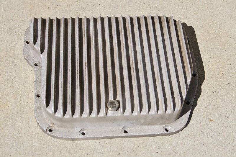

I know this won't answer your questions but FWIW next time I change the filter in my Super Bee's 727 I plan to install this. Picked it up last year and it seems to me the cooling fins could possibly help in cooling the transmission fluid.

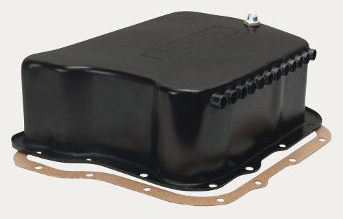

I like this one, note drain is at the front, which is usually the low point on the pan when on all 4.

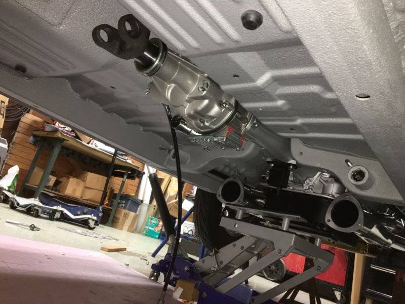

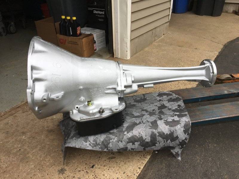

Derale Pan with cooling tubes for me. Really deep and holds over 12 quarts with converter and cooler. Doesn't hang any lower then my Moroso 7 qt Oil pan.
