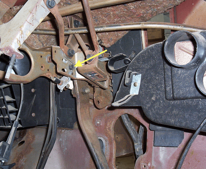

Sorry, phone battery ran low last night so I had to stop writing. Another problem I encountered yesterday was the car stopped shifting into 3rd. That made me pretty nervous. Was able to limp into a little church parking lot in a town called Fairfield. Not sure if it’s Illinois or Indiana. Fluid looked fine and I wasn’t sure what to do. I’ve always had manual transmissions but then I remembered someone on this post talking about kickdown linkage so I checked it. It was kind of binding up and not springing back. Wasn’t sure though because I’ve never dealt with it before. Anyway I was able to get to an Autozone just down the street for some wd40. As soon as I had it sprayed it sprung right back into place when I pushed on the linkage. Another forbbodiesonly member saved me by mentioning that linkage. I really appreciate everyone’s help! Thank you.

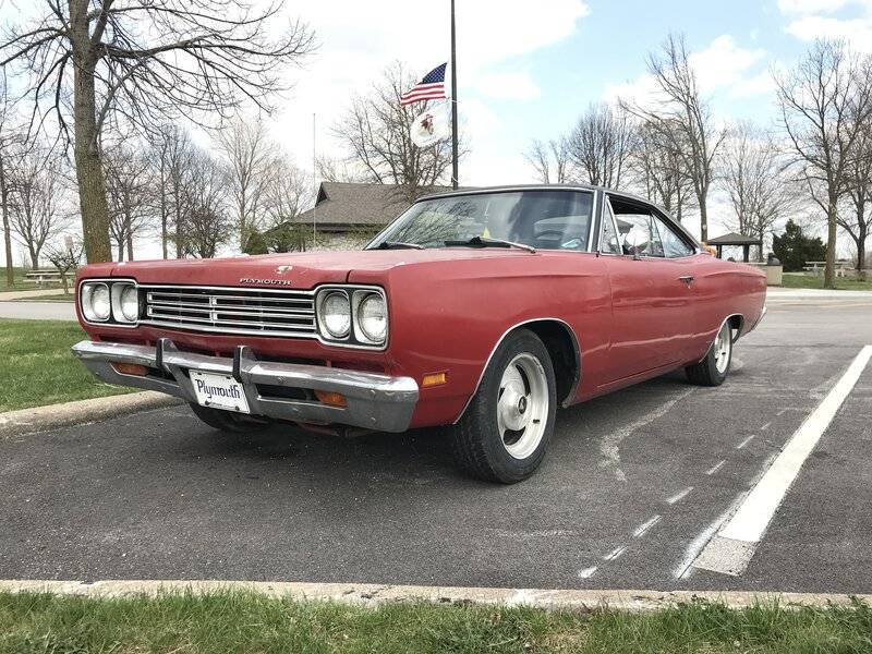

Looking at that driver side tire you might want to hit an alignment shop
If you are referring to the picture in the garage they sometimes will look like that if you jack them up and set them down because the control arm kicks out when you take the weight off. I think it looks better in the parking lot picture it may not be that big of a deal. Yet I wouldn't be surprised if the bushings are in need of replacement.
