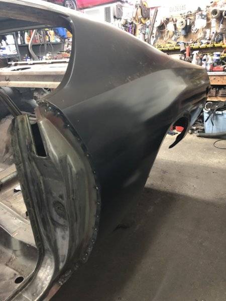

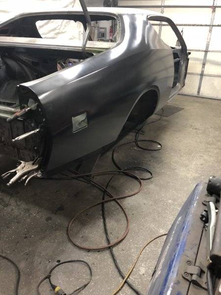

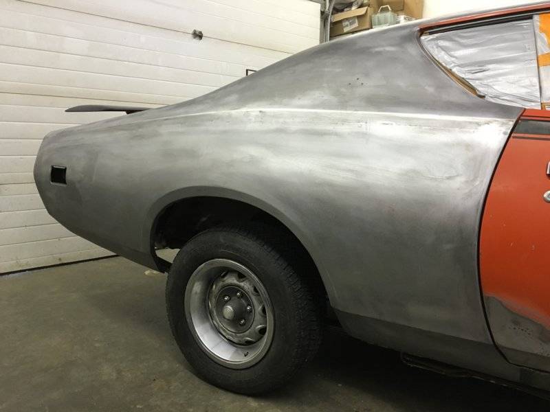

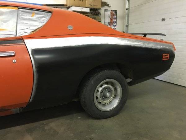

Thought I would share a little info with other 71 Charger owners that may need quarter panels.
I just completed the installation of and AMD quarter skin on this 71. 72 would be the same situation.
On this car, I elected to use an AMD quarter skin, rather than a full quarter. Reason being, I didn't want to disturb the lead at the roof seam, or remove the back glass etc, plus the upper was all good, so I decided to leave as much original intact and undisturbed.
I used a new AMD trunk extension and reinforcement bracket as well. These panels are heavy gauge metal, just like original. They have the same flanges and dimensions as the originals too. I butt welded the new panel in place and metal finished the weld joint. No body filler required. The fit of this panel was excellent. The door gap, rear valance, quarter extension and wheelhouse fit was spot on. I cut the new panel 1 1/2 inches below the body line to keep the factory body line in place. I will re-lead the rocker joint as the factory did.
I could not be happier with the fit and quality of the panel. The marker light opening is accurate, and the flanges have crisp bends just like the original panel.
hats off to Auto Metal Direct for these awesome parts for our 71-72 Chargers!

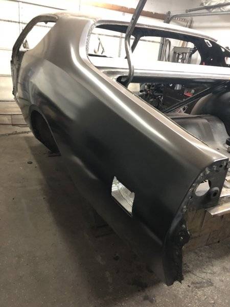

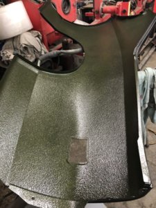

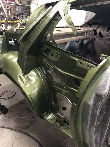

Nice work, I am in the process of doing a total restoration on my 71 440-6 Superbee. I have the car mounted on a rotisserie and just finished the front and rear full floor pans. Then I swapped it back onto the scissor lift to keep the car square while I cut out and replaced the full trunk pan and extensions. Then I moved onto the drivers side full quarter replacement and today the passenger full quarter. ALL was with the use of AMD quality replacement panels and the fitment was excellent . In the past I would have only addressed the minor rust spots with pieces of metal. But with the quality of the AMD stampings it was a no brainer to do this car right. Here is a pic of the drivers quarter after it was spot welded into place and after I cleaned, primed, applied sound deadner and painted the insides of the panel and structure prior to welding to ensure complete coverage and uniformity of the paint once the panels are in place and it’s impossible to reach certain areas

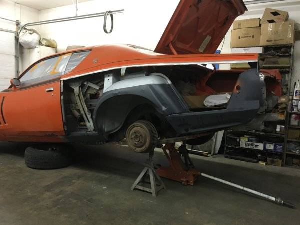

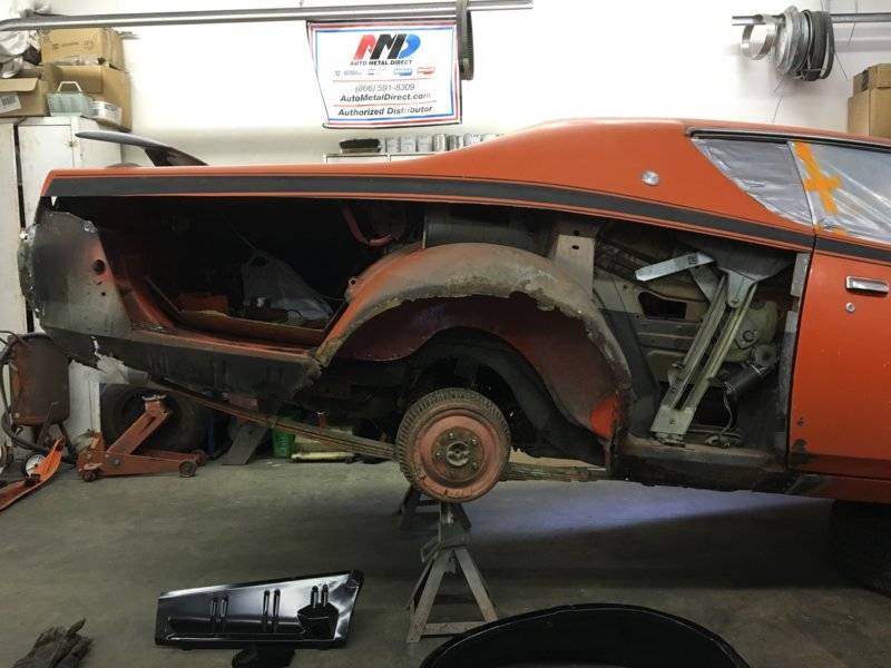

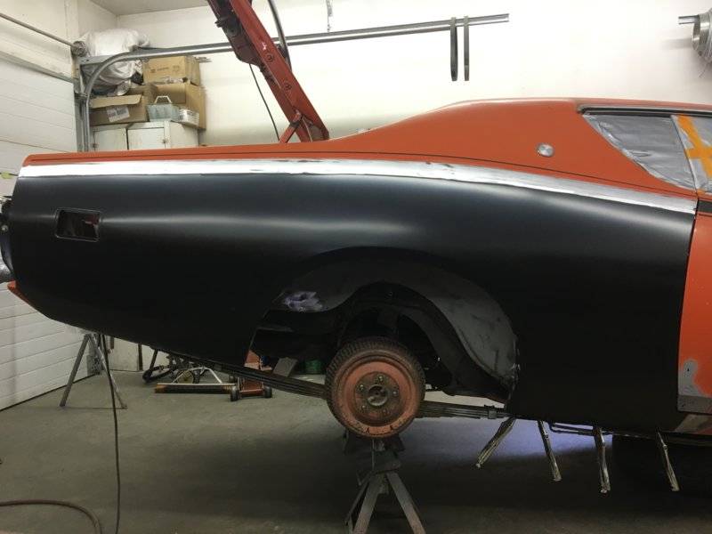

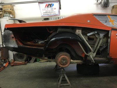

Some photos of the other side too. Used AMD quarter skin, outer wheelhouse, trunk extension, and the small filler piece behind the quarter extension (by the trunk lid). Fit of the AMD quarter skin was fantastic. Door gap is dead on. Virtually nothing for filler required to smooth the butt weld. Thanks Auto Metal Direct for making these much needed panels.
