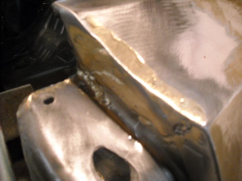

Looks like it was already fixed once, with brass. Can't MIG around that stuff, probably can't get the two pieces apart either.

I'd try to see the backside with a mirror and flash light or you should be able to feel it. That should tell you if it was fixed correctly. If not the best option is to grind out the brass and start over.
There's no inner panel in the car so I don't need a mirror I can look right at it, but there's a brace right there so I don't see any brass on the inside.
Sounds like it should be ok to me. Since its brass and not welded it was probably done around 25 years ago. If not longer.
That patch just confuses me - there's nothing to bolt the striker to and that's what cracks out.

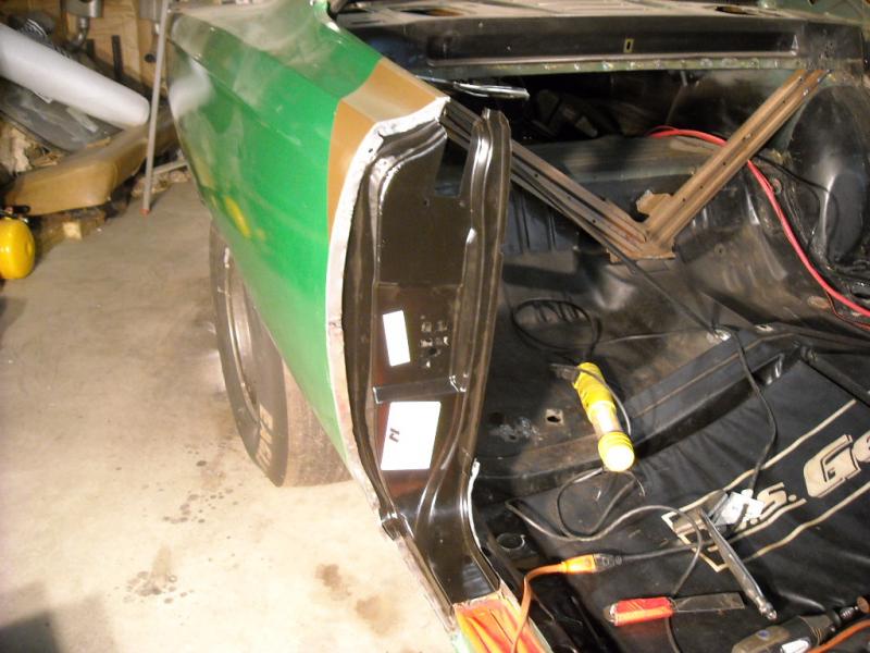

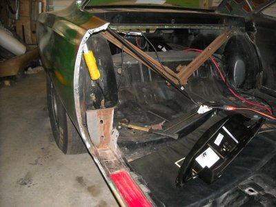

Making some progress here, got one jamb out without messing up the quarter. No wonder body shops don't take jobs like this, and those that do charge an arm and a leg. :)
The $64,000 question is how the jamb goes back in behind the quarter with that vertical bracket in the way. I tried a few times and decided I'd had enough for one day. It's pretty much a puzzle, and I figure there's a way to start it, turn it, and boom it falls in place. At least that's what I'm hoping for anyway.
Also wondering about the very bottom where the jamb goes behind the quarter down at the rocker panel. It was leaded over, and I'm wondering if there's a weld down there or if it's just lead holding me up.
Any info if you've been there before are greatly appreciated!

Take your map gas torch and sweat out the lead.You will find a couple of spot welds.How many welds will depend on how much they smoked or drank that day:eusa_whistle: Drill out the spot welds and pull back the qrt a little.This should help with installing the new door jambs.You will also be able to make some adjustments to make the qrt fit the door better if need be.
Cool, thanks. The quarter's not going anywhere, the jamb was messed up not the quarter. The place that race prepped it thought it'd be a good idea to bolt the windows up so they could eliminate the regulators to save weight. So they drilled through the top of the jamb. They cut out the inner panels too. I guess they knew a future owner would want to learn to weld.
There was some old rust at the bottom too, so replacing the whole thing was the cleanest way out.

FWIW, looks like if I get that little tab and bit in the curved corner of the quarter bent out a little bit the jamb may go in. That little corner bit holds it up about 1/2" from where it needs to go. But I still can't find my plumber's torch to get all the lead out so I'm going to just cave and buy a new one today.
Progress - a little bend here, a little trim there and it went right in. I was even able to get it back out - twice. Now to finish prepping so I can this one welded in and get on to the other side. I should be using Mr. Lincoln this weekend.
