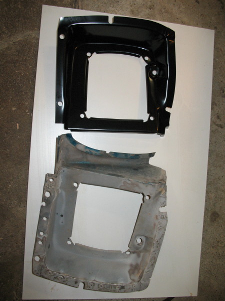

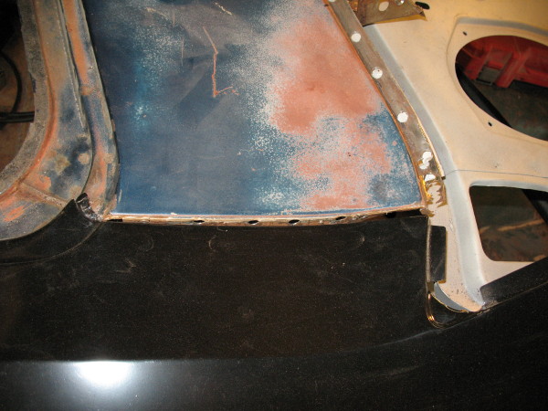

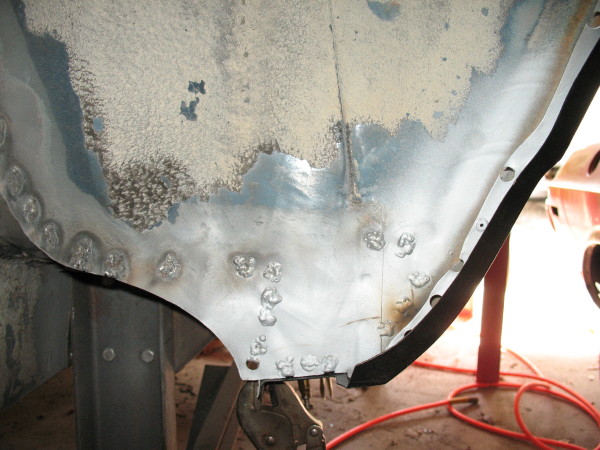

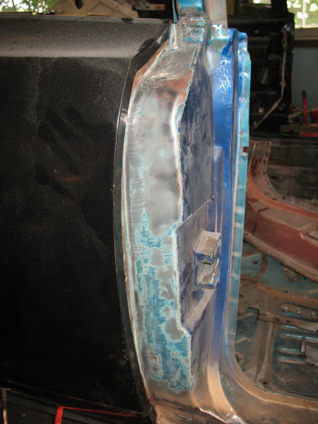

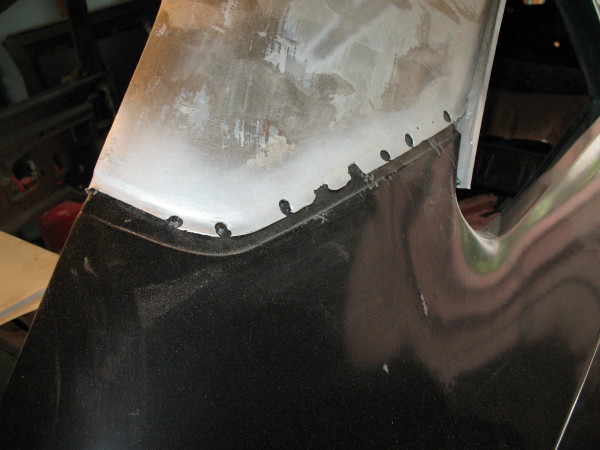

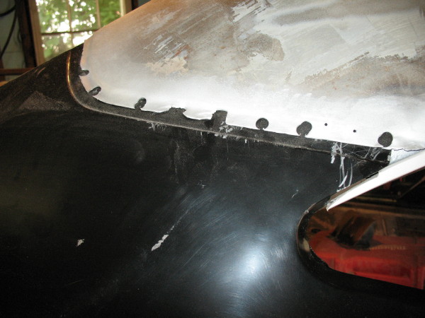

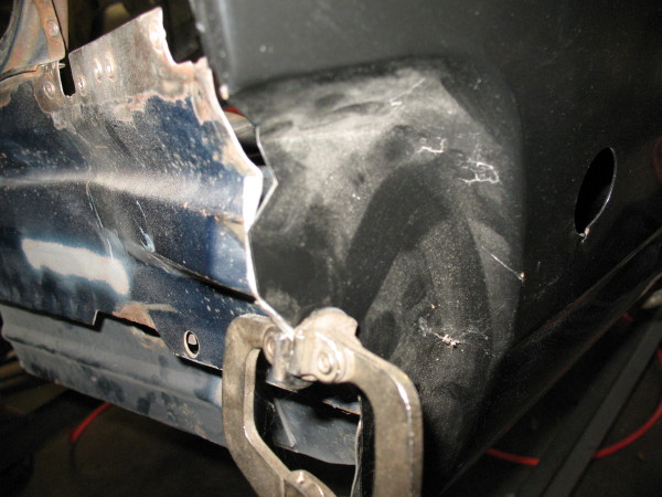

I am in the process of installing them on my `68 Road Runner right now. I have only had one clamped in place, while I prepare the other side so I can clamp it in place to make sure my trunk lid fits before I weld everything up. So far I would say there fit is very good and I'll keep you posted. Check out my gallery for some pics of the process.

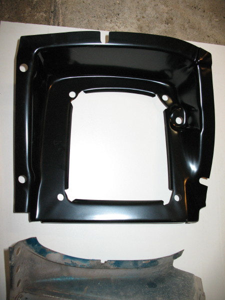

Just thought I would share some pics of the AMD quarter and how it lines up at some crucial points. At this point it is still just clamped in place but overall I would say that it lines up very nicely. Had to buy one taillight mount and it matches the oem piece exactly, very nice stuff. Also bought inner window channel corners, tail panel, rear footwell pans and driver side floorpan. If anyone wants to see some more pics, let me know and I'll post them, otherwise I'll post as I make progress.
