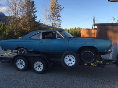

Hey guys, this is my first post here. I just purchased a roadrunner in need of some surgery. It needs new quarters, outer wheels houses and trunk extensions. I went on AMDs site today and looked up parts and noticed they have a full quarter and a quarter skin. I only need from body line down. Other than the obvious that I can see, what's the difference? image.jpg
I just brought it home today and my 5 year old daughter told me to take it back, it's in rough shape.
