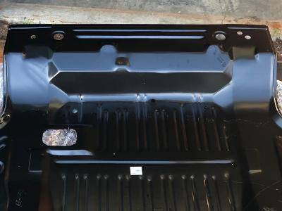

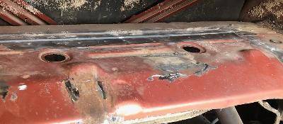

I see a couple raised areas that my original doesn`t have but my center area was cut out by a previous owner. Anyone have pics of a factory `70 floor or can show me what inaccuracies there are in the AMD part?
Raised rectangular area on AMD part but mine is flat.
Can’t show a pic, but I believe that’s a relief to make space for the ends of the support that goes across at that point.
Ok, I see that now but I guess mine just isn`t as pronounced from the factory.

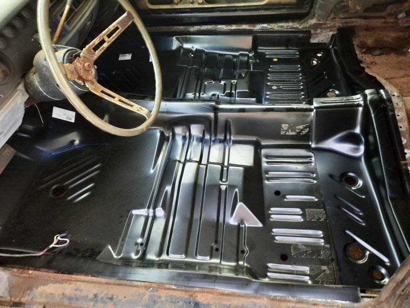

I haven't done the trunk pan yet. However, the AMD full floor pan fit reasonably well. The contours and bends are not as crisp. It did the job.
