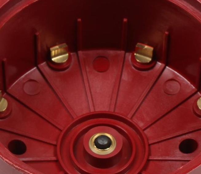

Could you post picture of the burnt crater?
Yep. Black cap is my "crater", the red cap pic is from the inter webs, but what the new cap button looks like.
