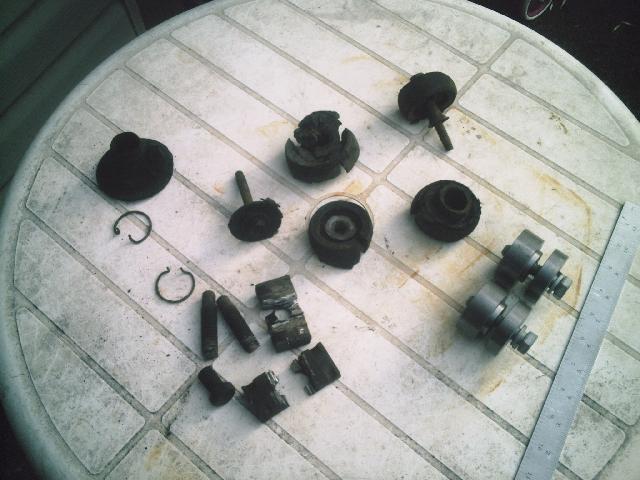

Here's the bits and pieces of the adjusters I cut out as well as the rubber torsion bar isolators (or whats left of them) and the new steel ones I'll be using

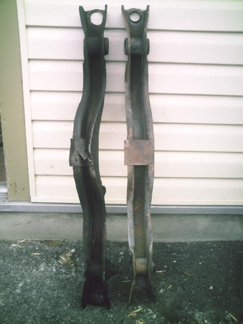

I'll be adding the picture of the old twisted torsion xmember in another thread as well as I said I would, but wanted to share it here too
