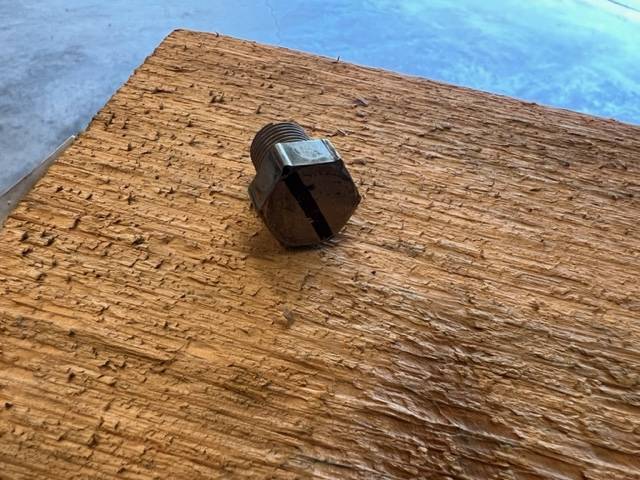

Any thoughts about how to get this out?

A while ago I was asking questions about torsion bar adjusters and came away with the conclusion that the ones I installed when I swapped the torsion bars and rebuilt the LCAs were junk. They went partially in and then refused to turn any more. So, I bought a new set which I went to install today. The old ones, both sides, refused to move. My 1/2' torque wrench could not loosen them. The impact wrench moved one of them a bit and then the bolt head snapped off. After a few choicer swear words, I took some pictures which are attached.
I think I basically have two options; Try to drill out the broken bolt or get a sawzall in there with a hack saw blade and carefully saw the adjuster base in two. But before I do anything I thought I would seek some advice..

A cutting torch is a good tool at this time. However your parts are clean and painted so that may not be what you want.
try some lubrication on the next set of bolts.
Weld a nut on the end and crank it out.
I'm pretty sure you know this but if not, you need to have the front wheels off the ground when tightening/loosening those adjuster bolts.
Your best bet right now is to use a sawsall and split the square piece. It'll come out easily
and you won't damage anything else. Yes, you'll have to buy new ones, but just bite the bullet!
Anti-sieze on everything!!!!
The bolt is hardened and you won’t be able to drill or saw it out. You might be able to disconnect the lower ball joint from the spindle to relieve enough pressure off of the bar in order to remove the bar and the lower control arm. Make sure that you have a floor jack under the control arm when you do this. Once you have the control arm off you should be able to cut both ends of the adjuster bolt off with a torch in order to remove that plate.

Yep, thread a nut on about half way on the broken end and then weld inside the nut to the stud. Soak the hell out of it with penetrant and work the bolt out in increments to keep heat down and reduce the chance of galling and seizing.

Thanks for the confirmation... I already have the new ones and was trying to remove the old ones to get the new ones in... I'm going to try the sawsall first. I'm not sure how hardened this stuff is but we will see. I would hate to have to take the front end apart for this but I will if there is no other option. I don't have a torch and my welding skills are not that great so I will work with what I have. Do you think a heat gun might help out on the other side (also stuck)?

The fact that actually snapped off being the size they are is suprising...you shouldn't be able to snap one off with a 1/2" drive bar if it is clean like that....looks pretty soft to me and not much heat treatment or hardening.

You do realize that there is spring tension on that bolt dont you? think about that before you try anything to get it out,
a 1/2” impact might not be a good idea either , you have no feel when ur reaching the snap point , use a breaker bar or long handled ratchet , if it get real tuff to turn go in opposite direction, put on your favorite lube , now turn in (lower) the other direction, if all that fails it’s time to cut ….and as others said , when assembling use lube or better yet never - sneeze

Yep, I do realize that.. But you know, even if I disassemble the front end and take the LCA out, I'm still going to cut the thing to get it out, probably the same on the other side as well...

Some serious heat on the square nut might help....as well as welding a nut on the broken stud.
A sawzall might cut one side of the nut - or if you can get a fresh cut-off disc on a grinder up there.
Also to answer the question at the top - any amount of tension on the torsion bar will prevent it's easy removal - you'll end up breaking more stuff in the process.
If you still have the shock and bump stops installed it's not going to move very far if you cut it.
I'd put the tire on it and put a jack under the wheel as well if you're able.
A cutting torch or plasma cutter would be best.

A new sawzall blade and cut the square plate in there I'd go 1/2 way through from each side if you can as that plate is loaded and might bind on the blade.
I think it would take less than 5 minutes.
