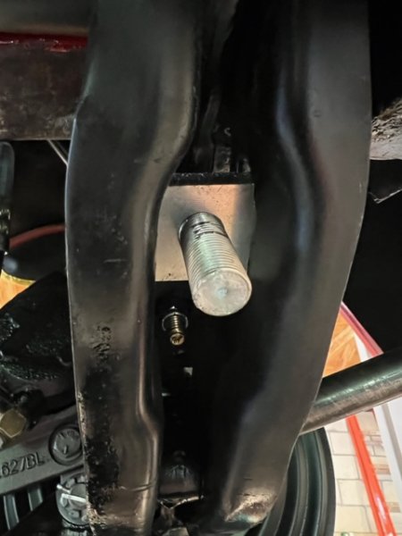

Been there, my 73 had broken OEM adjusters when I bought it. My first choice is torch, I can have them out in less than 5 minutes a side. Yes you will scorch paint. Raise the car high enough to be able to work with the suspension hanging. Cut off the lower half of the bolt flush with the nut first. It preheats things, but the nut won't come out of the LCA if it's still there. From the front, start cutting the top half of the bolt flush with the nut. As you cut, pressure from the torsion bar will slowly push the bolt towards the nut, so keep cutting. When it's loose, use a long screwdriver to push the hot slag out of there. Be sure to let it drop to the floor, it's still very hot. After it cools, install replacement parts and adjust ride height.
Second choice would be a drill and long bits. Your adjusters don't look to be OEM quality and hardness so this may work. Drill a 3/16" hole on the inboard and outboard sides of the nut. Continue to enlarge the holes until the nut is weak enough to break using a cold chisel. I believe this would be a lot easier to control than a saws-all, and maybe save paint.
If the nut proves too hard to drill maybe try a Die grinder with small stones on the inboard and outboard sides of the nut. Keep grinding till the nut is weakened enough to break.
Good luck and stay safe.

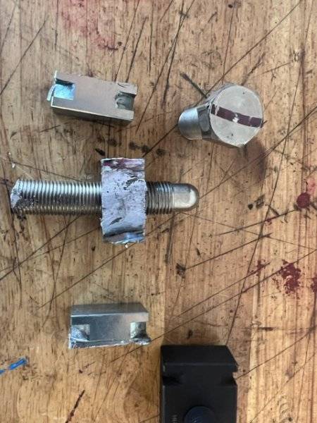

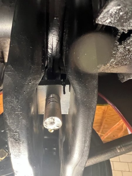

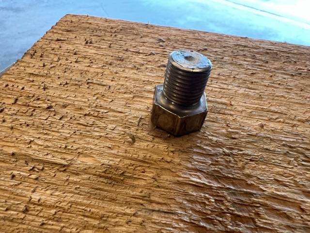

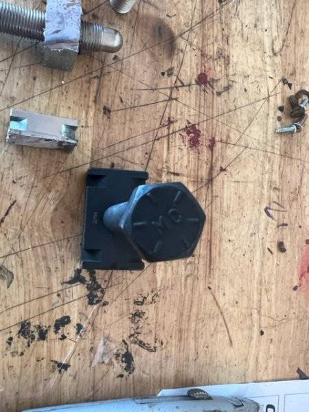

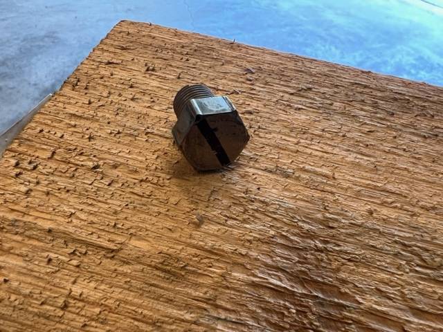

OK, I managed to get one side done via sawzall. Bought 5 "thick steel" blades plus one carbide tipped. Went through all six but got one side out. Raised the front end, removed the wheel, disconnected the UCA bumper and removed the bottom shock bolt , let the suspension sag. What's interesting is that there was no stress on the adjuster.
Check out the pictures... The bolt that was in there looks to be a grade 2 as opposed to the new one which is a grade 8. I'm no expert but looks to me that the ones I originally bought were junk...
Installed the new adjuster with gobs of copper anti seize compound, went in just fine..
Another lesson learned (the hard way!). :)

The broken bolt looks like Chinesium.

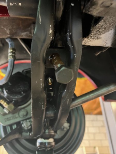

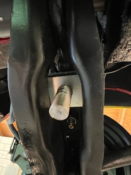

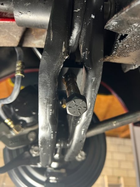

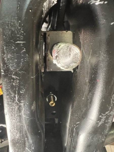

A while ago I was asking questions about torsion bar adjusters and came away with the conclusion that the ones I installed when I swapped the torsion bars and rebuilt the LCAs were junk. They went partially in and then refused to turn any more. So, I bought a new set which I went to install today. The old ones, both sides, refused to move. My 1/2' torque wrench could not loosen them. The impact wrench moved one of them a bit and then the bolt head snapped off. After a few choicer swear words, I took some pictures which are attached.
I think I basically have two options; Try to drill out the broken bolt or get a sawzall in there with a hack saw blade and carefully saw the adjuster base in two. But before I do anything I thought I would seek some advice..
At this point I have removed the wheel and UCA stop but that is it... Is it possible to remove the torsion bar while in this state?
Thanks as always!!
Joel
Take the weight of the car off the adjuster, weld a nut on the end of the broken adjuster, dress the threads so you can screw the new nut on as far as possible before welding. Take a torch and heat the square block dull red and use an impact wrench to remove the adjuster. Make sure you do not heat the adjuster bolt just try and localize the heat in the square block. Burp the air gun and watch the adjuster, make sure it is spinning out and not twisting to break again. And the old saying goes you have to strike when the iron is hot. If the square block cools or transfers too much heat to the adjuster bolt let it cool and start again. Drilling is an option but a slow and difficult one. As mentioned the bolt is hard.
