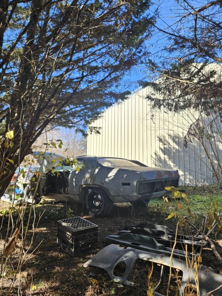

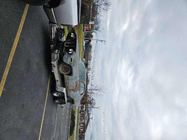

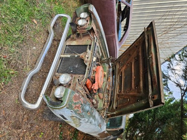

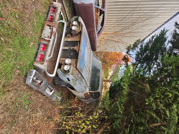

Had a thread here about my '71 roadrunner I was fixing up, ended up selling that one and this one followed me home today.

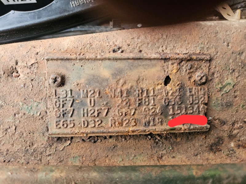

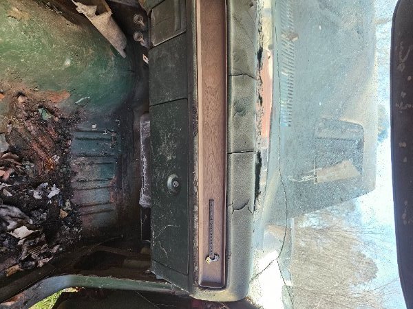

'71 Roadrunner, 383 auto/column. Factory bench but long gone. Engine appears to be numbers matching but I'll have to check. Going to see if I can get it running and driving and back on the road!

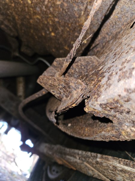

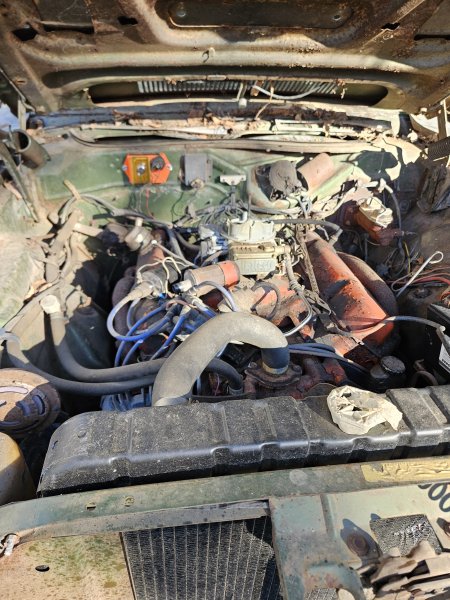

Had some time to dig into the car today, with a new ECU and ignition coil I got the 383 running. Did some digging and parts inventory to figure out what I need, also discovered a spot of rust on the frame. Will be putting it up on the lift this week to see what I got myself into.
Another update on the '71 Roadrunner!
Got it up on the lift this week and the underside needs some help, ordered a safe-t-cap and floor pan. Those PA winters are harsh.

Will keep you all updated! Next phase is brake lines and master cylinder. Then I'm going into the engine bay to straighten out the cooling system and I picked up a nice high rise dual plane for the 383 and some other goodies. Then, hopefully I can get some of this metal done and I can start worrying about wheels and tires.
Another update on the roadrunner! Snow pictures are from before we got hit with a foot of snow in the northeast. Snowpar!
Took care of this water pump that was worn out. And did some upgrades to the cooling system
Dropped a new aluminum radiator in to keep it cool this summer, did trans lines, belts, battery tray and all while I was in there.
