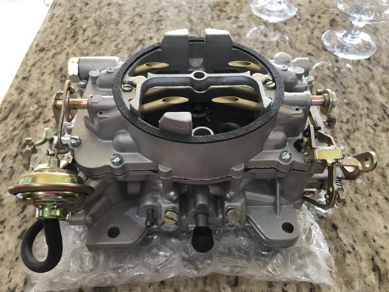

Not exactly sure of the infatuation with Edelbrock (aka "Eddy") AVS2. The AVS2 is a basterazation or hermaphrodite of the origional Carter AVS. The AVS2 has "down leg secondary booster venturii assemblies" BELOW the air valve blade, different from the original design of straight downward pointing discharge nozzles (better air flow). The AVS2 offers additional venturi assemblies, that are reputed to have annular discharge features. The origional carb was Carter AFB design, of which Carter built millions of them....reliable, easy to tune, many parts are available, plus it's origional to your car. If this is important, get the otigional rebuit. If not, an origional Carter AVS could/should be considered.....and all accessories fit and function, with the exception of the air filter, which has a 5-1/4" dimension; the origional AFB carb has a 4-7/8" dimension. The choice is yours.....personally, I like the origional look. .....or you can join the EDELBROCK AVS2 faction....and shoe maker the installation. Others will definitely offer their opinions......just my opinion of course.....

The Edel modification to the original AVS design of [ Edel ] using venturiis in the secondaries......was a PLUS. That is because the Carter AVS had specifically placed holes along the length of the secondary discharge tubes, which varied in number, position & hole size. Left side was different to right side. These were specifically calibrated carbs for EACH engine they were used on. Change something such as cam or intake etc, & the calibration goes out the window. Adding sec venturiis gives the carb more tuning abilities as a universal design. A plus.

I ran an Edelbrock 800 AFB (model 1413) I think and thought I had it running pretty good after going through it and getting the jetting back close to stock. But the I found an original 4327S and had a full restoration done to it and put stock jetting in it. Not sure about full throttle power but the 4327 seems smoother and more responsive to throttle changes in everyday driving than the 800 cfm Edelbrock. I’ve read the 800 series carbs are not ideal for the street and tend to run rich so the 750 cfm models might perform a bit better on the street. But the Carters sure look good too, all restored.

If you have an original AFB for that HP 440, they are around 750 cfm. In my opinion, It would be hard to get a better carb. The 4327s was calibrated from the factory for your engine and transmission and when up to snuff are hard to beat. Original Carters had 3 step rods instead of 2 step universal rods, to ensure the right mixture at all rpm. Idle, cruise, and WOT.
