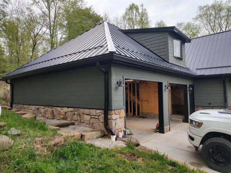

I ran triple 2×12's with 1/2" plywood sandwiched in between to bring them out to 5 1/2" wide matching the studs. Another thing working in my favor is there's really no weight other than the roof over the left door, on the right side because of the 8' wide dormer the trusses are doubled up with an 8' gap in-between so all of the weight is sitting almost on the door ends. On top of that once I finish trimming the interior for mounting the garage doors I'll put another beefy timber across the top. Should be fine.

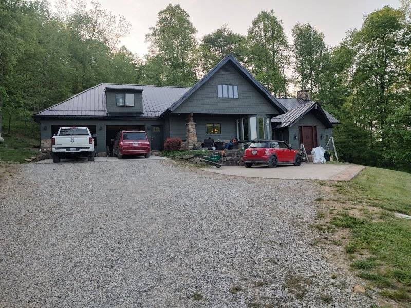

Still plugging away here and there, mostly stripping the old stain and restraining the rest of the house at the moment but did get the dormer sided as well.
