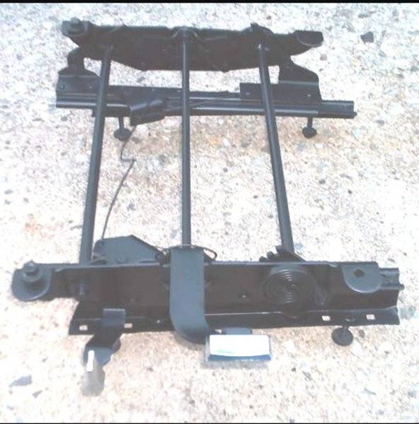

1968 Satellite seat with buddy seat center. Has anyone here taken a later model 6 way power seat mechanism and adapted it to a stock seat? I think that would make a great " how to" article................................MO
The M body six way seat frame is really, really close to the "classic" six way seat frame.
It would not be hard at all to retro fit it. IIRC the front mounts are different, and that's about all.

I don't understand what you are saying. What is an M body, and what is a " classic " six way seat frame? Thanks..........................MO
M body is 5th Ave, Diplomat, and Gran Fury (also LeBaron, IIRC).
Realistically a power seat is probably only going to be found in a 5th Ave, but nearly all of those have them, and probably 60% of LeBarons, but I see WAY more 5th Ave's in u-pills. I see at least 2 per year for the past several years in my JY circuit.
By "Classic", I mean the 68-70 seats.

I didn't know they had 6 way power seats in 68-70. Maybe that is what I should look for. Anyone got one to sell? ...................MO
Came out in 69
70 ha a power option, IIRC.
68-70 are typically around $600 IF you can find one. More for power.
M body at JY is about $25.
Raise and lower the seat front or rear edges.
Is it easy to adjust? You know how tall I am , and the wifey. She wants the seat raised up, and I want it lowered. She is long legged, and forward-back is not so important. You know where I can get one? it should bolt right in...............................MO
