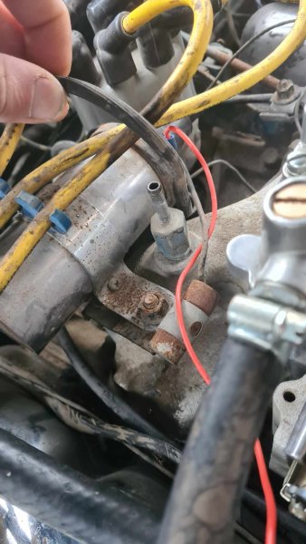

Coil is receiving 12v from ignition.
There is a condenser connected to the coil, could this be causing the issue? (it's in very bad shape)
Thank you for any help to sort THIS issue. Yes, I'll consider upgrading it in the future but I need this car working ASAP because it's blocking access.
External condenser is just a noise filter for the radio. Disconnect it, but doubt that's your issue.
Disconnect all unnecessary stuff from the coil. Looks like a bunch of add ons
Disconnect the electric choke for shits n giggles

just take the condenser wire off the points and see if it starts that will tell you if the condenser is bad.

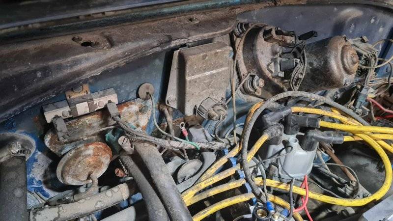

Your wiring looks like it's in less than ideal condition. Any crimp terminals that show green corrosion where the wire joins the crimp pin could be problematic. The electrical paths described for ignition switch and coil all go thru the bulkhead connector. And yes, a bad condenser can also create a problem. Inspect those connections as well.. Hope this helps...
This problem could have many causes.....
- either condenser could be faulty
- open cct bal res
- corrosion of bulkhead terminals
- wiring
- coil
- carbon tracking inside dist cap
- etc
didn't know that was possible, I'll try.
wow, that's a lot of information, thank you very much. It's so frustrating because I drove her the day before and it was working "fine". Reading about it it makes sense being the condenser, it was popping a lot and I noticed a bit of struggle going uphill. The car has been completely neglected, previous owner had no idea about cars at all. I'll be asking a lot of things in the forums for the next coupe of weeks. :D
sorting the wiring is definitely priority.
