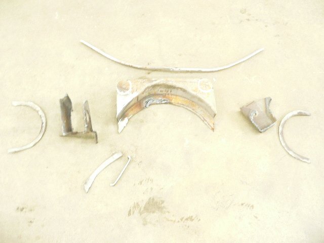

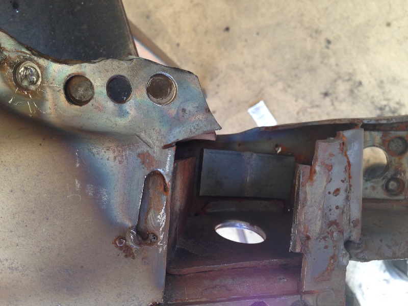

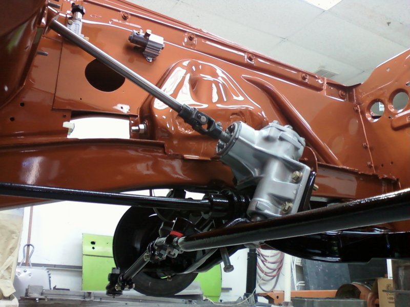

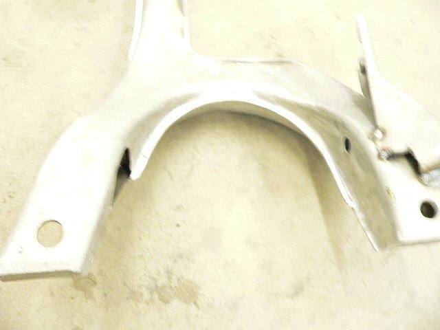

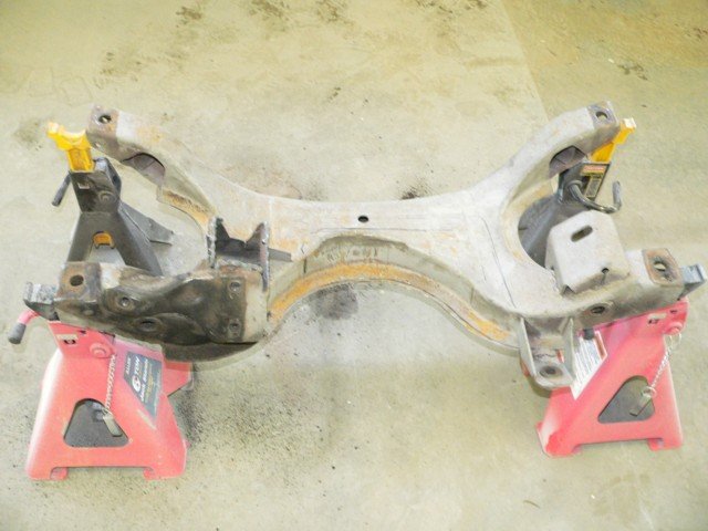

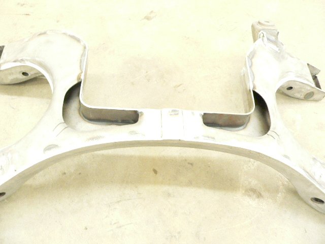

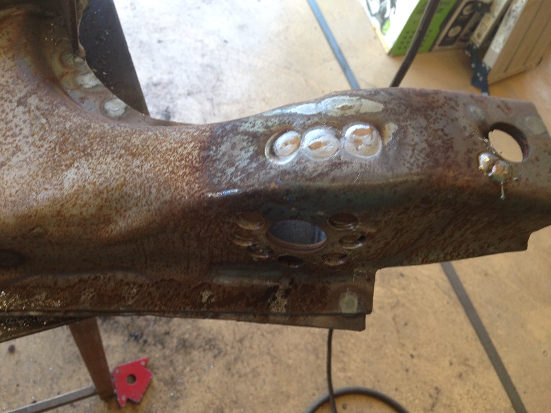

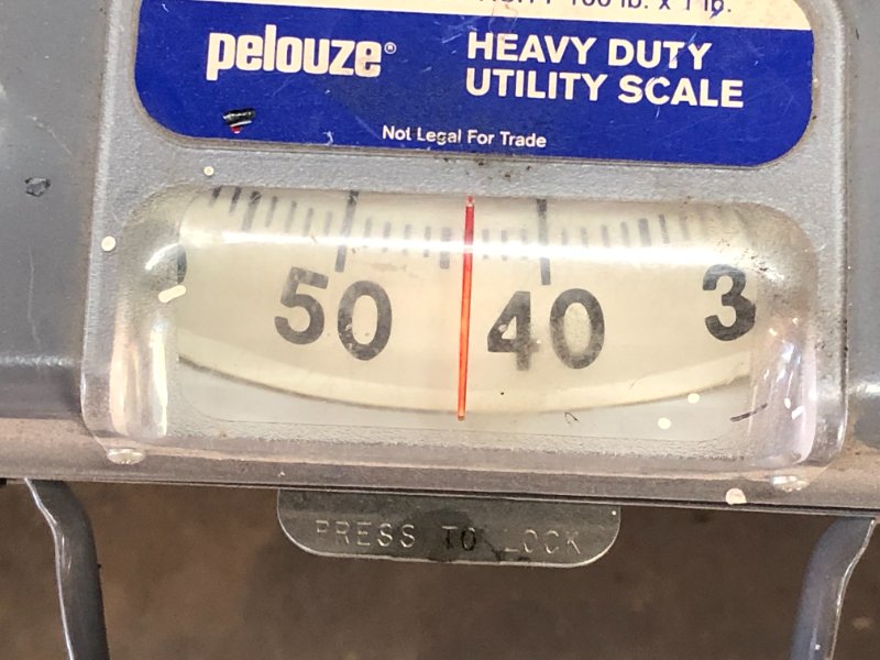

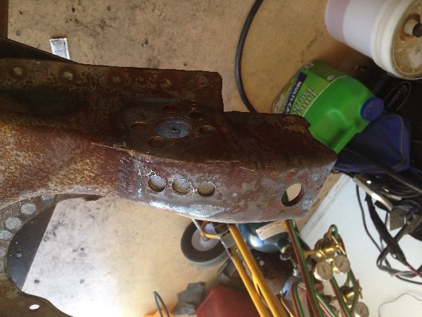

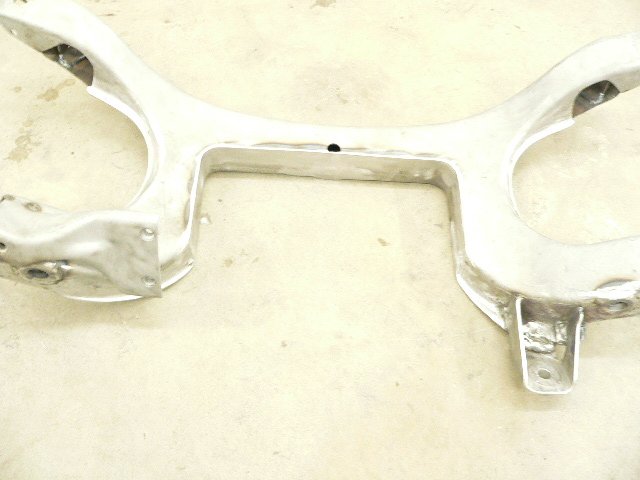

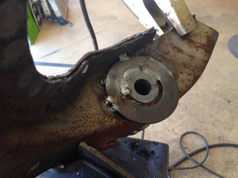

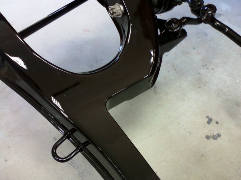

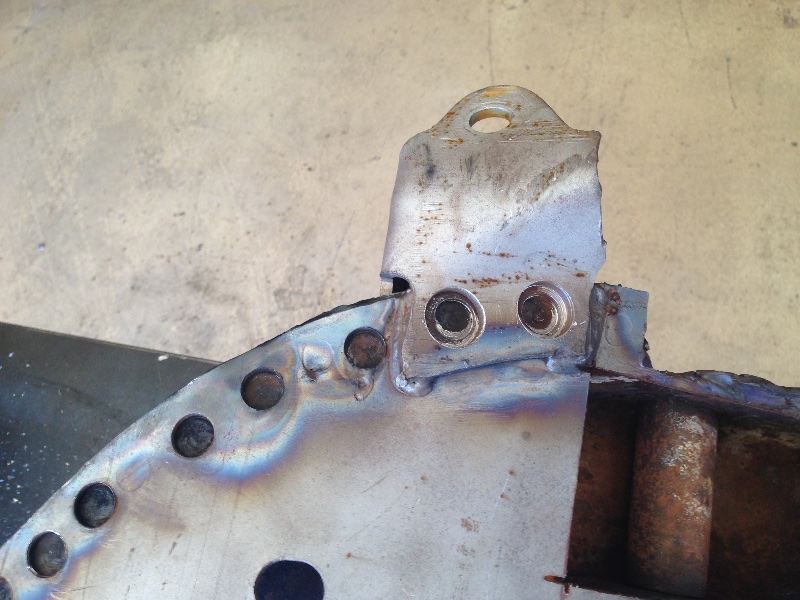

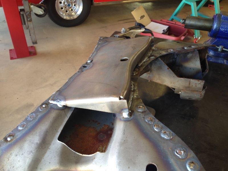

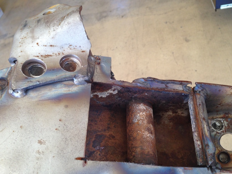

The K frame in my car has been heavily tested. 1250 runs over 13 years with wheelies every pass. The flanges were trimmed and tack welded as is was cut. A hole saw was used to make a nice radius for the oil pan cut out. Two oversized inserts were tacked into the oil pan cut out. Then trimmed for a flush fit. The motor mounts were removed. Leaving only the flat mounting area for the steering box. The box mounting plate was gusseted with two pieces of .090" moly tubing. The lower openings were filled with sheet metal for appearance. The steering shaft and strut rods were fabbed out of the same .090" moly tube for additinal weight savings. I wouldn't sugest these mods for a road race car but for a drag car they've worked very well.
Doug
Other than cleaning up the welds and stiffening the steering box area. The only other things I would consider is reinforcing the strut rod holes and replacing the press fit pitman arm attachment flange with a 68-70 u shaped yoke style attachment. Much less flex and better pitman arm availability if you want to use the longer pitman arm for faster ratio steering.
