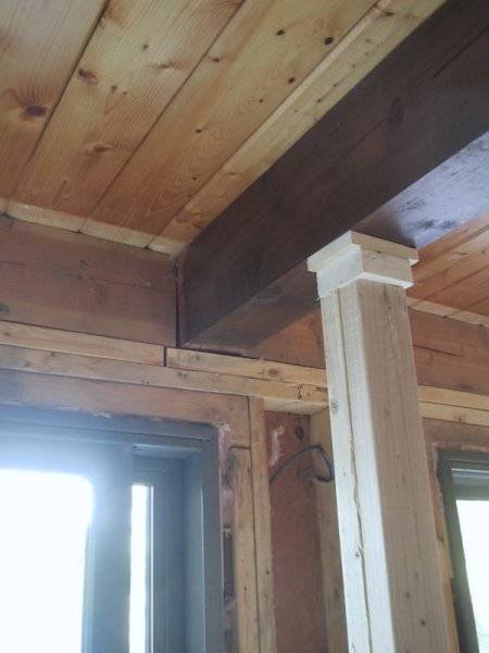

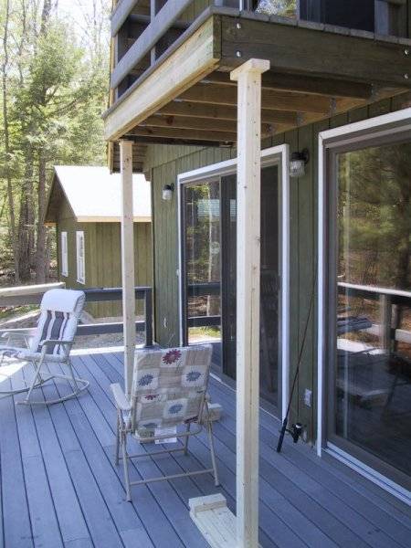

I had the same issue over my sliding doors 15+ years ago at my place in NH, which is somewhat built like a post & beam construction. One winter, we couldn't open one slider because of the snow load on the roof. In the spring, I stripped off the interior walls & you can see below the the shoddy construction that caused this issue. The beams go through to the exterior and support a balcony above and the first step was to take all of the weight off and strip out all of the garbage construction.
Since I couldn't get a proper wood header in a 6" space, my solution was to install 1/4" X 3" X 6" box channel steel supported by 4X4 posts on each side of the slider.

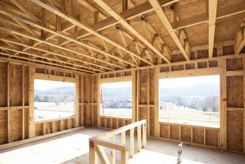

Around my parts we would frame it more like this but notice there is no rim board
in this photo.
Technically, those joists have full bearing at the top plate but have a 2x4 or 2x6 band along the top....recessed into the end of the joist. The band is there to provide backing to nail the floor plywood.
69 Sleeper
in this photo.

I was trying to show more about the fact that the floor joists sit on the wall without the rim board and thus you need a header over any opening.
