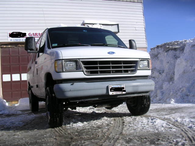

I took a 12v drive train, front half of a Ram frame and stuffed it all into a Ford Econolone. Best van I ever had. Drove it for 15 years. not one break down, 300K on it. I finally retired it due to rust. Frame is still good, but I'm gong to build a heavier one next. An other not so great picture, but you get the idea:
