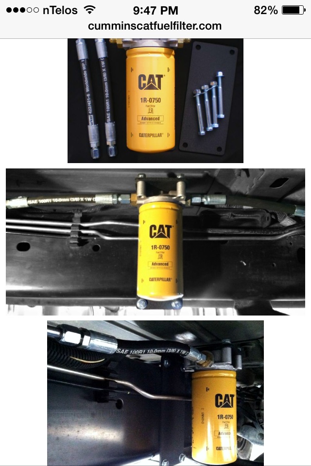

Just installed a cummins cat fuel filter system today. $169 from throttle up industries. No drilling required. 2 micron filter. It mounts to the frame rail. It's supposed to only take 45 minutes to install but mine took a little longer. Where I had to cut the fuel line was in a bend and I had a very hard time getting the compression fitting on. No leaks and it's running great. Very cheap insurance for all my new injectors and pumps. Quality product and it arrived in 2 days with free shipping and tracking.
image.jpgthey also make a dual filter kit for $249

I had to mount mine behind the transfer case instead of in front of it because I have a fass ddrp lift pump mounted in front of the case. I would have been done in less than 20 mins. if I could've put it in front.
View attachment 180177they also make a dual filter kit for $249
