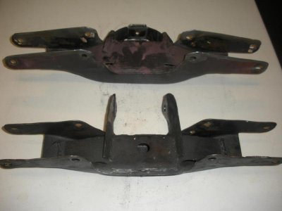

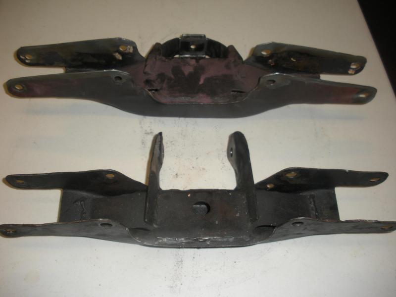

After years of dealing with 4.10 gears in the Charger, I finally installed a Gear Vendors overdrive unit. I wanted to drive this car more than just within a 20 mile radius, so this unit will really help. I slipped in a 3.23 gear for last years trip to LA for the Spring Fling, but swapping the diff is always a compromise. The overdrive ratio of the GV is .78.
The install was pretty easy. I modified the stock trans crossmember to allow me to use a spool mount, and dimpled two small areas to clear the GV case. The stock Charger driveshaft was stowed away. This particular GV unit has a fixed yoke, so I had to use a driveshaft with a slip yoke built in. The wiring was amazingly simple. On the road, it simply feels like a 4 speed auto trans. Momentarily after the upshift to 3rd, it shifts into OD. The 4.10 chunk developed a whine, so I swapped in a quiet 3.91 SG. This makes the final drive in OD around 3.05. Hopefully I'll do a little better than the 11 mpg I got last year with the 3.23 gear.
