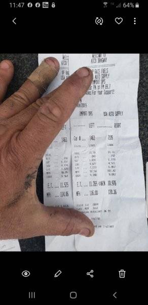

And people thought it wouldn't go 11.80. Just goes to show you that all the strokers,
new pistons, nice bore/hone, fancy ring packs, and compression aren't what everybody thinks. A lot of overkill on street motors.

Exactly. I usually tell guys that are on a real tight budget to skip building the bottom end and put all the money into the heads. Most posters will take exception to that approach.
And beyond the unnecessary big $ short blocks, don't forget the "must have" 0.300" rocker shaft spacers for that perfect rocker arm geometry.
I set my shift light for 6000.
Put a rev limiter chip of 6300
I wouldn't even get to 5400 without stumbling so the shift light never went on.
Seems like it would need to go 6000+ to get to 116 mph.

But I did hit 116!

If you could have had some time to get the stumble and bog off the line sorted out it would probably crack the 10 second ET. As mentioned earlier a well sorted out chassis along with some decent cylinder heads and camshaft a BBM will run.
I was 'kind of close' on the 1st full pass
of my org. range of the low prediction of 11.59 (?)
almost 400hp @ 3100#'s,
I thought that was being really optimistic too...

Depending on weather, I may have another 2 weekends at test n tune before they shut down.
I'm going to give it a shot!

I originally started it for the first time and it had 33* in it. At the track I bumped it to 36*.
FWIW, I've gone 42° in this kind of air and it kept picking up. Frankly didn't have the nerve to go 44°.

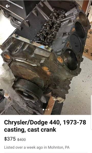

I'm scouring salvage yards for Chrysler Imperial's for my next engine...:thumbsup:
